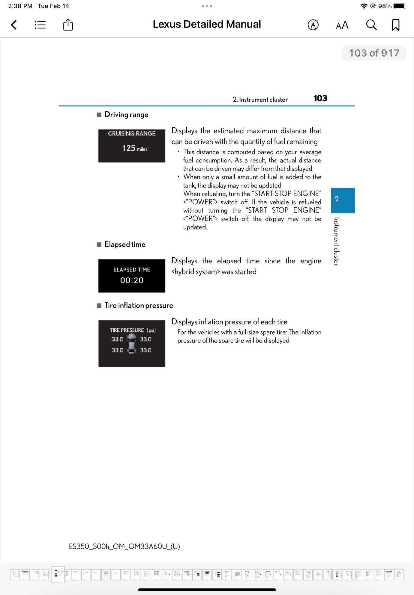

Thanks pab12 for responding. They are the original TPS sensors. My initial thought is that it was a bad sensor, however I went to a tire shop and they walk around to each tire and scanned it and informed me that they were getting a signal from each TPS. Not sure if a low battery would still give out a signal but cause the light to blink and stay on and the display turn read dashes.........I may just have to pull the trigger and get new sensors. Was your TPMS light blinking then staying on as well at start-up?

Normal life expectancy on the batteries used in this generation is in the range of 8-10 years so you're in that range. A weak battery might cause the TPMS to be read by a hand-held reader close to the sensor but missed by the receiver in the vehicle itself. If you're up for new tires any time soon I'd get them changed then...save yourself some extra mount/dismount/rebalance costs. Meantime just keep an eye on the pressures manually. Oh...one other thing...if you can, and before the batteries die completely, get and write down in a safe place the ID # of each of the 4 sensors. Might save you a bunch of car (Lexu$) reprogramming money if you can put reprogrammable sensors in as replacements. A few threads around here on that...the "Search" function is your friend.
