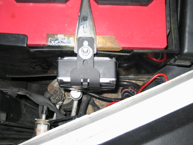

This is my older set of HID/Ballasts but i put the new ones in the same location.

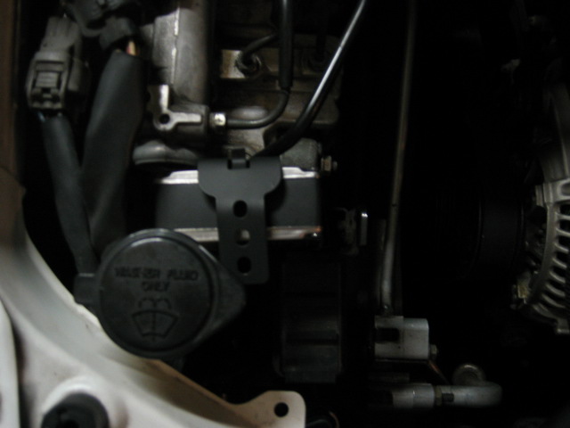

This is my '96. Only thing that needs to be removed is the headlight (I was doing a lot more work in this is why the bumper is off).

Wow. Thanks for all the help guys ! I appreciate the photo examples
