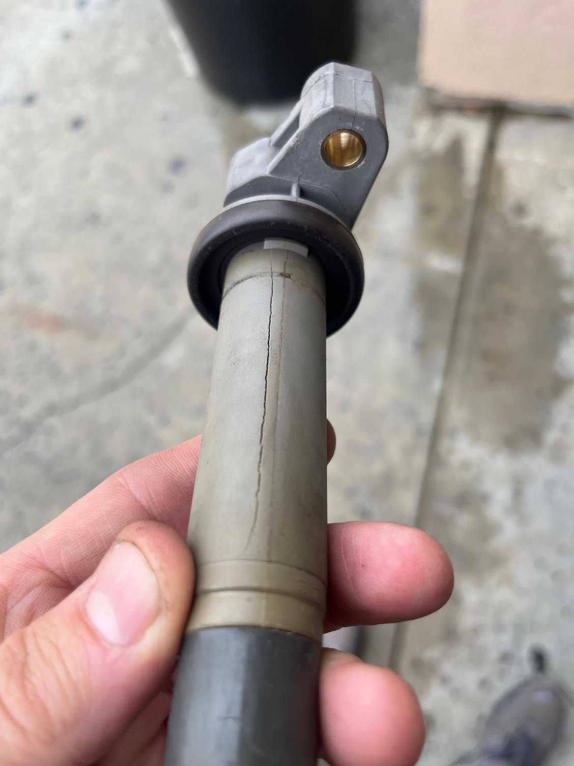

Update: Got a flashing check engine light. Plugged in my scanner and got a P0304. The misfire and hesitation was due to this ignition coil. Put one of my 25 year old coils and the hesitation went away. I will swap out the faulty coil.

I have all of the coils replaced with some from Oreilys. Not the best quality as seen on the attachment, but you get a lifetime warranty.
🤷🏻. I’ll keep 2 good originals just in case one fails on me.
