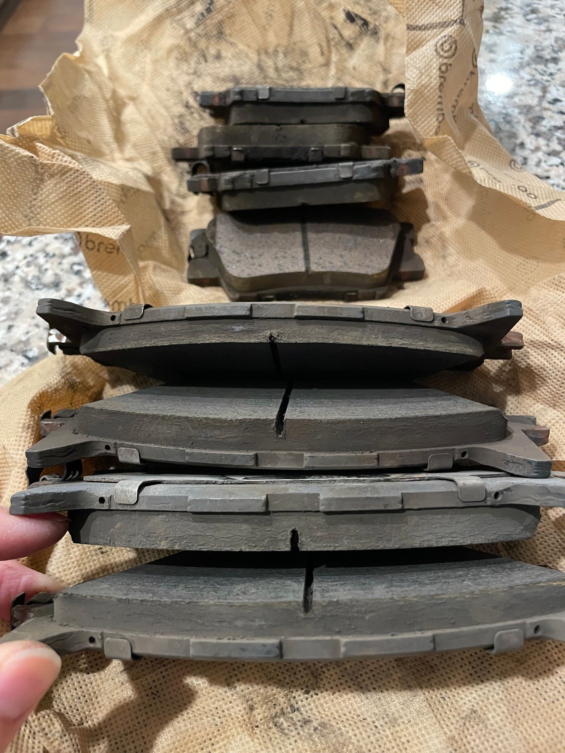

Here’s an update: had a friend bring one of those brake pad thickness gauges and measured the passenger rear. The outer pad had plenty of life but it was harder to get to the rear pad and it looked like it was low. Went ahead and ordered brembo pads and rotors for $208 shipped from Rockauto and paid a shop $300 to replace it. Picked up the car and the shop showed me the old pads and rotors. Said there was so much life left and I could’ve gotten a rotor resurface. I’m a little irked they didn’t mention it but in their defense I didn’t say much besides I wanted them replaced so they did their job. I’m very annoyed though that I gave in to the wife’s complaints.
