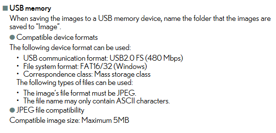

Here are the requirements from the Owner's Manual. I'm surprised you even have a USB 1.0 Flash Drive lol.
I was able to change the image with a cheap MicroCenter USB 2.0 Drive I got for $1.99.
Formatted in Windows as FAT32, Drive is completely empty with only a folder named "Image". Image inside the folder is a .jpeg named "test".
