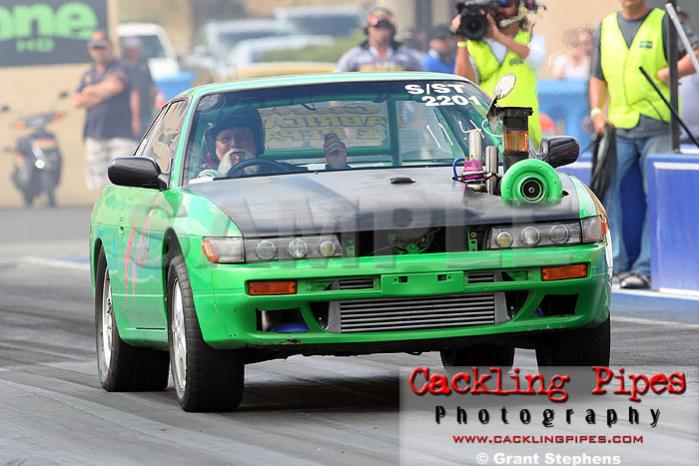

Hi Everybody,
Great news, I done 2 x 10 seconds passes last night in Baby Hulk :-)
I feel this is the BEST a STOCK 1UZ-FE engine and Auto has ever done !
( I beg to be shown different )
10.8 @ 131 MPH Pass
Followed by
10.7 @ 132 MPH Pass
Set up is as follows.
Vehicle;
Nissan S13 Silvia
Engine;
Stock 1UZ-FE with Coil on Plug
e420 ECU
Scania HX55 Turbo
Stock Exhaust Manifolds ( Flipped )
Larger Injectors
15 - 17 psi Boost
Trans;
Stock Aisin Warner Auto ( A340 )
Shift Kit
2,800 Stally
Manually shifted
Diff;
Stock Nissan S14 IRS
4.08:1
Fuel;
Pump 98 RON
Martini Octane Booster
Tyres;
MT Semi Slicks
Attached Thumbnails 10 Second 1UZ-FE-sdbracketattack301010_511.jpg   10 Second 1UZ-FE-sdbracketattack301010_166.jpg

thats a funky looking hood you got there,

Is that a Mr Fusion behind the snail sticking out of your hood? Looks like some crazy contraption you've got going there, can we get some closer pics of that?

Here are some snaps
Attached Thumbnails 10 Second 1UZ-FE-mixed-pics-019-640x480-640x480-320x240-.jpg   10 Second 1UZ-FE-mixed-pics-020-640x480-2-640x480-320x240-.jpg   10 Second 1UZ-FE-mixed-pics-021-640x480-2-640x480-320x240-.jpg   10 Second 1UZ-FE-mixed-pics-022-640x480-2-640x480-320x240-.jpg   10 Second 1UZ-FE-mixed-pics-023-640x480-2-640x480-320x240-.jpg
