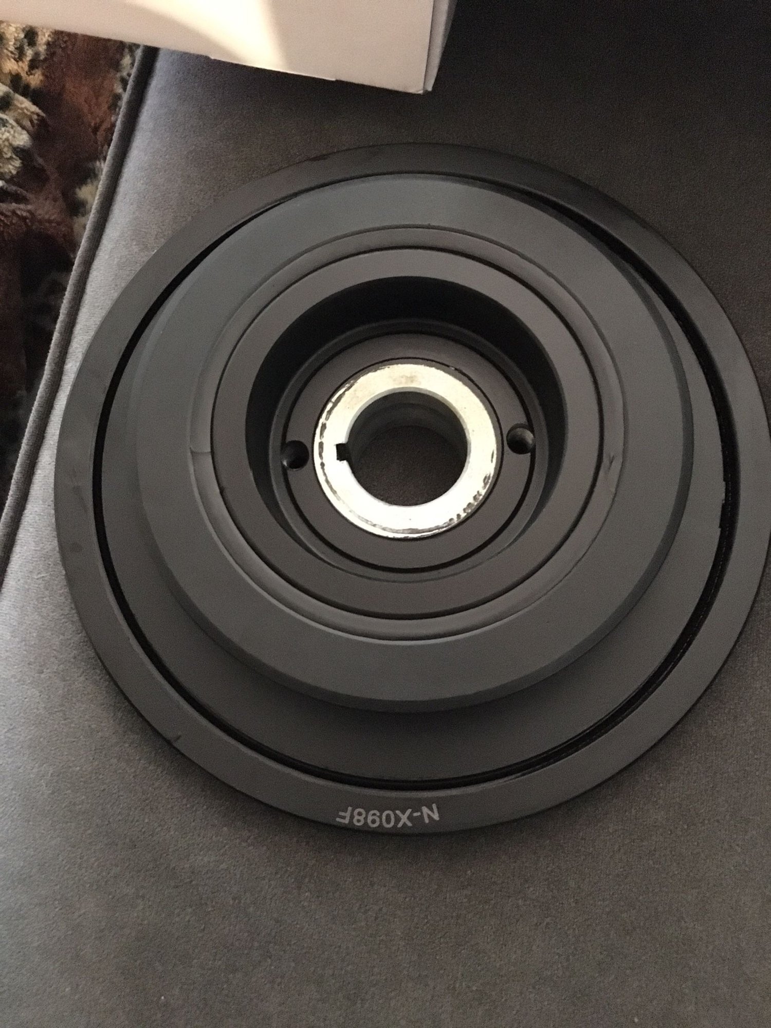

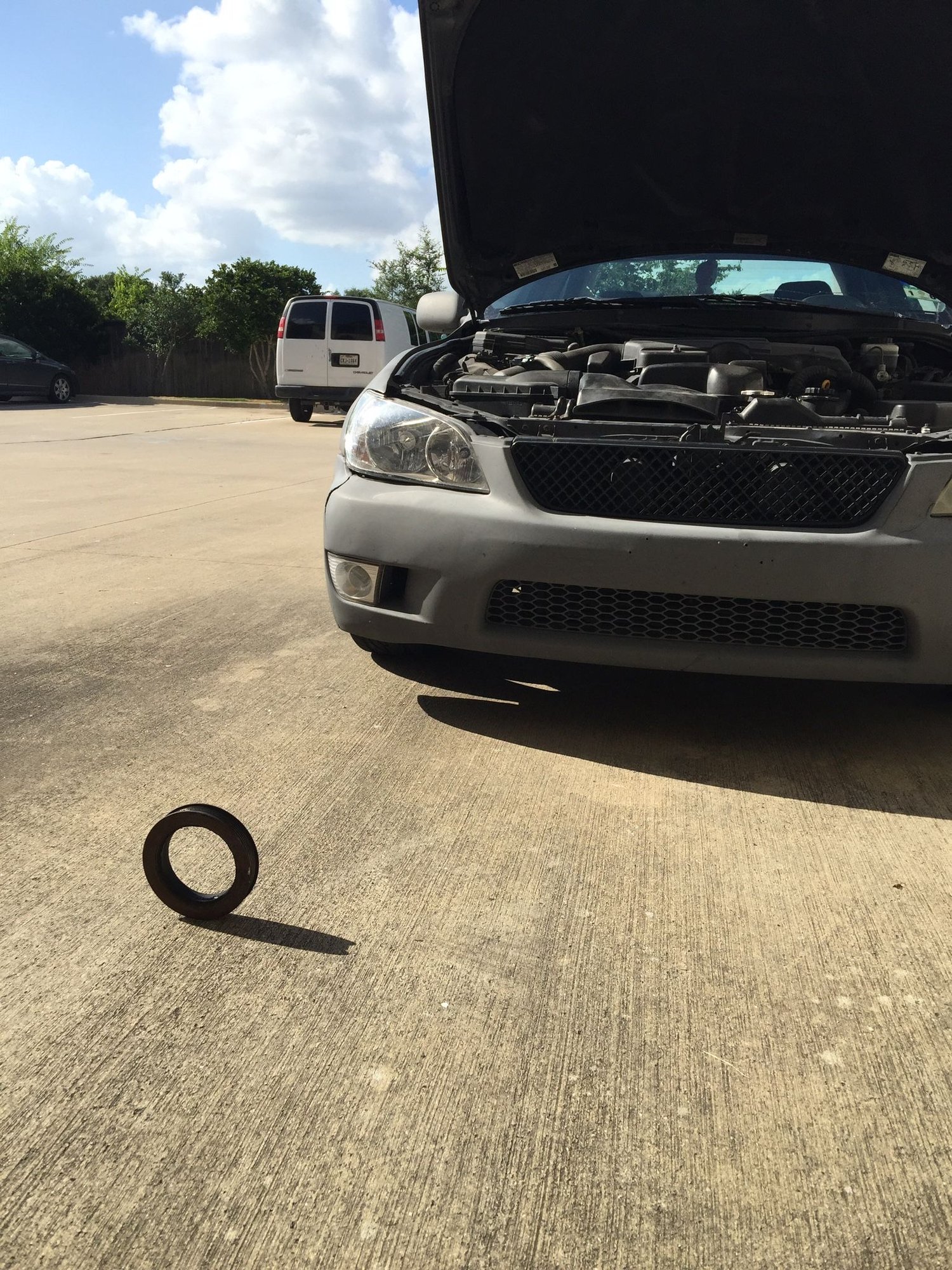

WOW!! was this before you came by to pick up your part?! I feel totally bad man but looks like you got it worked out? Thanks for everything and your GS300 is looking real nice 👍!! Let’s trade rims lol love the crv with BBS!!!and the g37 wheels!
yes man my is300 has problems after problems but it was a pretty rough example but I loved it and wish to get another one day
here is a photo of when My harmonic balancer said FU lol!! I’m not joking as it was as it shows, I mean the Accessory belt didn’t even snap it was still rotating on the car!! When ahead a bought a $50 one from amazon and it worked perfectly! I’ll be following your build!
