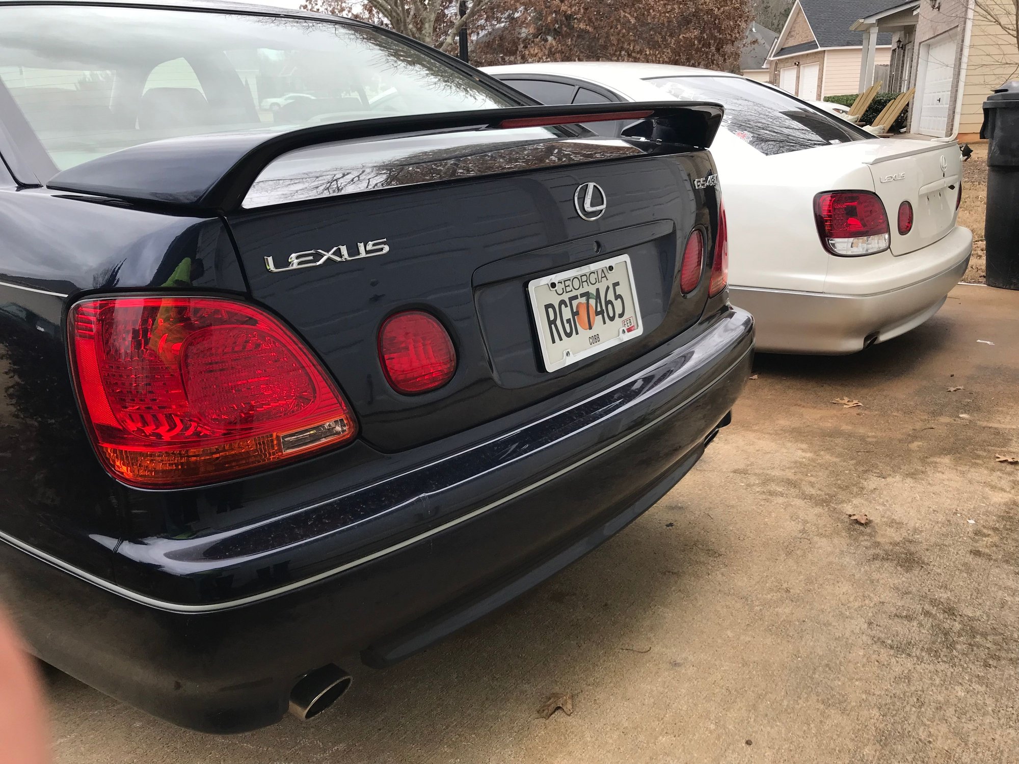

And also if there is any one that is close to Atlanta or would want to make a trip here, and would like to swap trunk lids. I have a perfect trunk lid 01 dark blue with the factory wing and custom black chrome emblems. I don't like the wing look. I know a lot of guys love the wing look. So if some one wants to trade blue lids. Message me on here. Thanks.

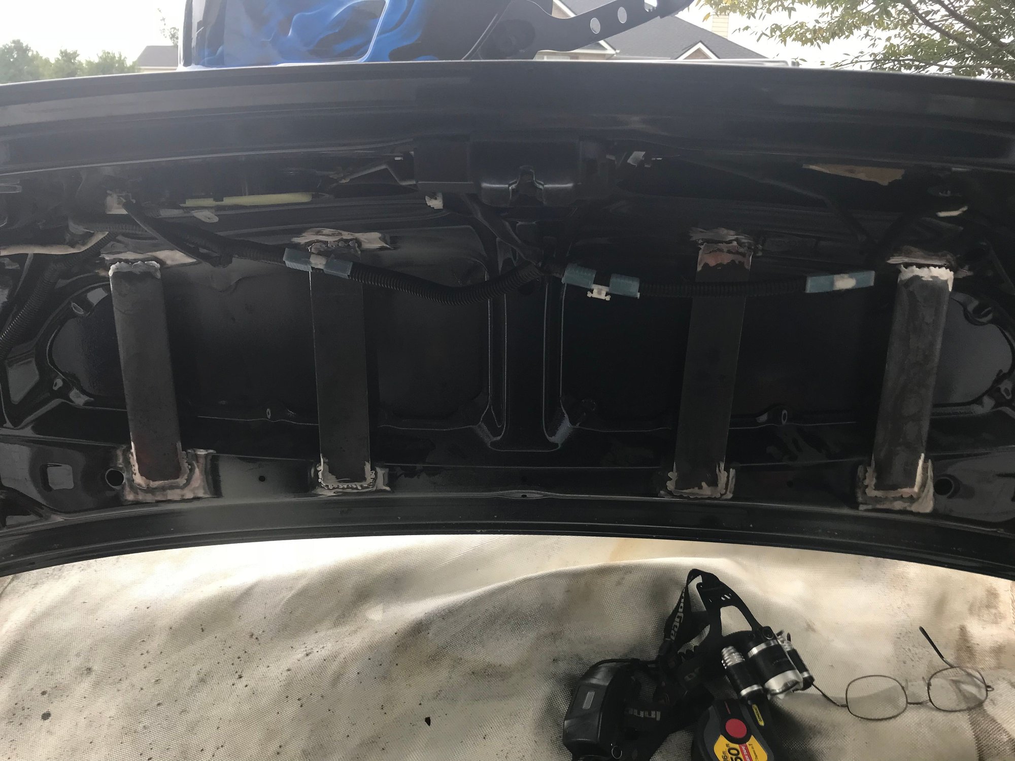

Well here's a update. For the last couple of weekends I've been working on the trunk. Getting the base set up for the air system. First I welded up the mounts for the air tanks and then had to make the hinge tortion bars stiffer to hold up the extra wieght of the tanks.

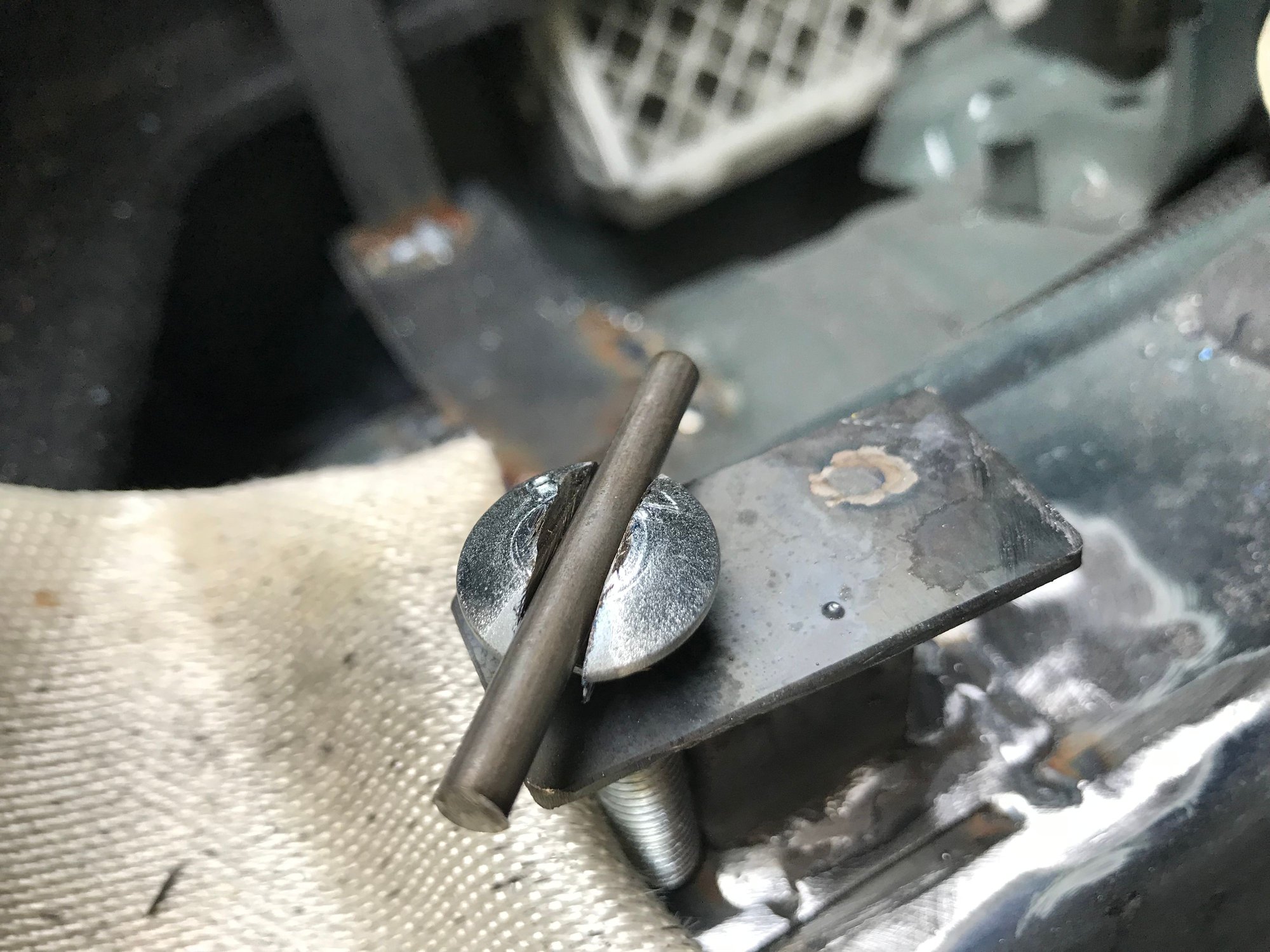

And to get the panels booked down I came up with this idea. I made these so after I install the wood flooring on top of the plywood I could tighten the nuts from below and not have the bolt spin.
