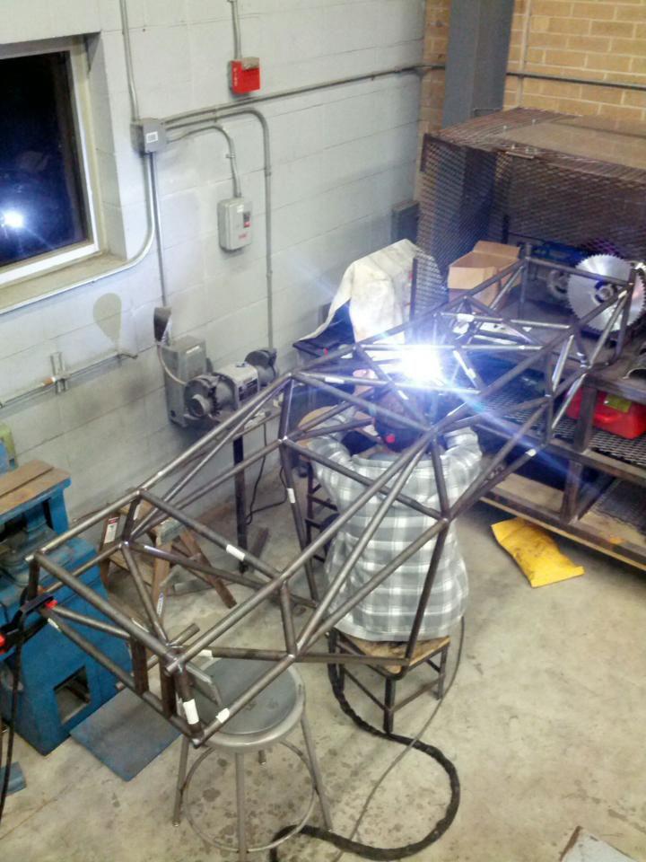

To give everyone something to look at while im making no progress.
This is the open wheel race car im building with some buddies.
Enjoy
Attached Thumbnails SupraYota BUILD!!!-car-render.jpg   SupraYota BUILD!!!-welding.jpg   SupraYota BUILD!!!-uprights.jpg   SupraYota BUILD!!!-rear-car.jpg
