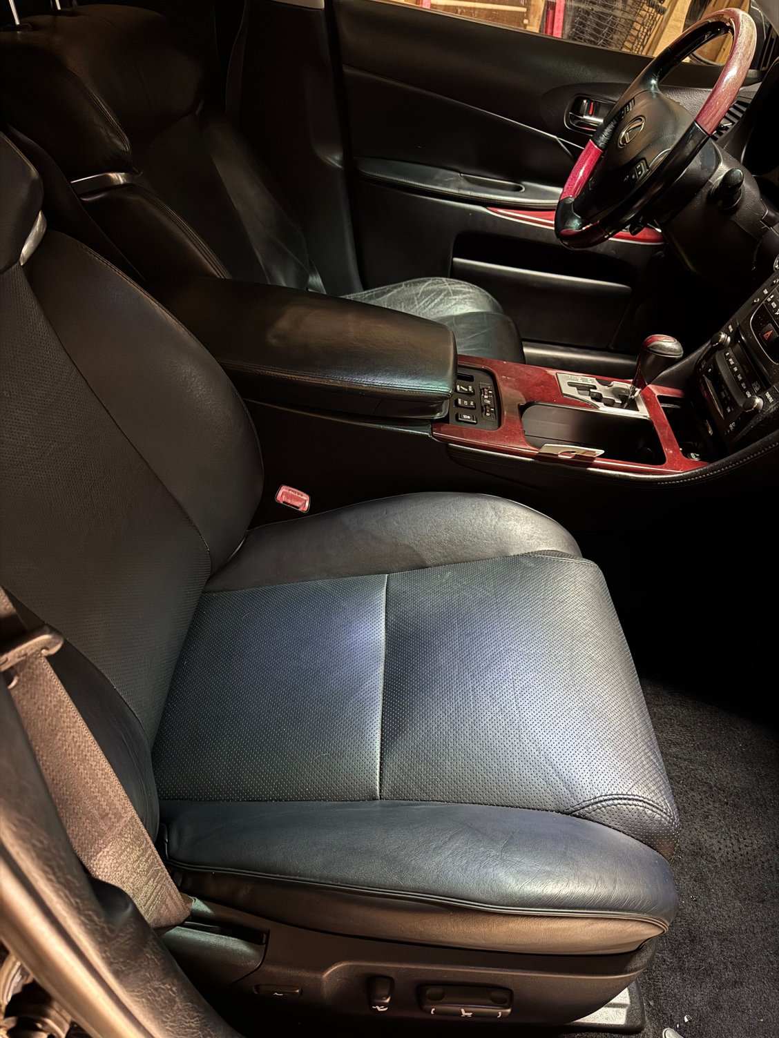

As I'm waiting for the parts I tried to address the interior issues. Passenger seat has a rip, I was going to order new covers but I found a seat on Marketplace.
Seat I bought is out of GS 350, so it's not same. I ended up taking it apart and just swapped the bottom part to my seat.
