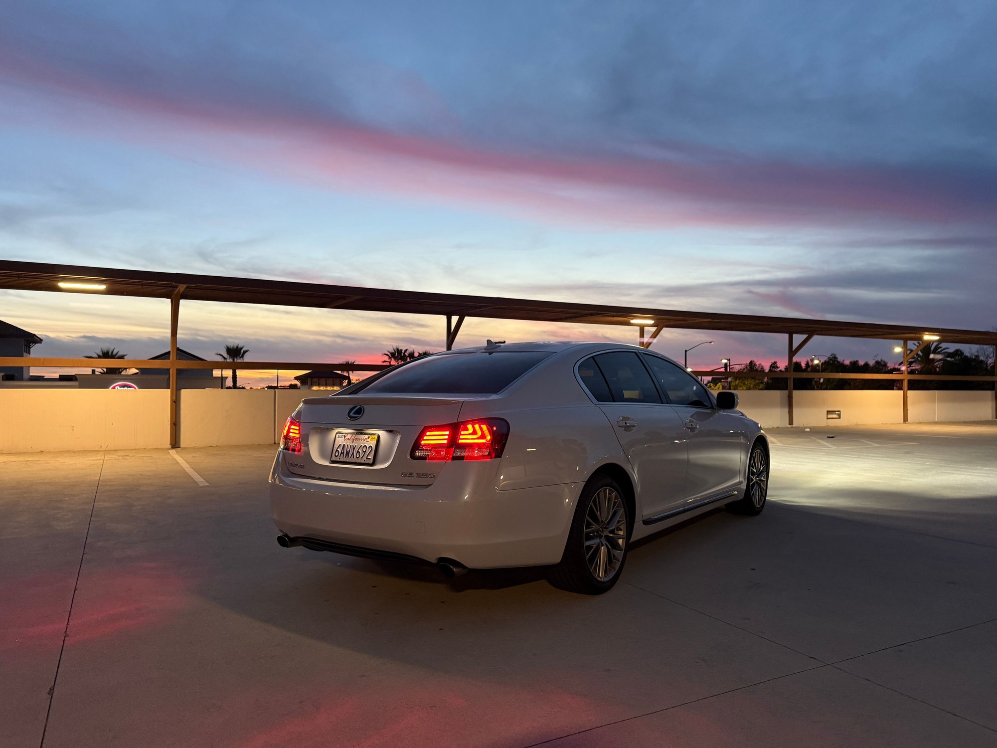

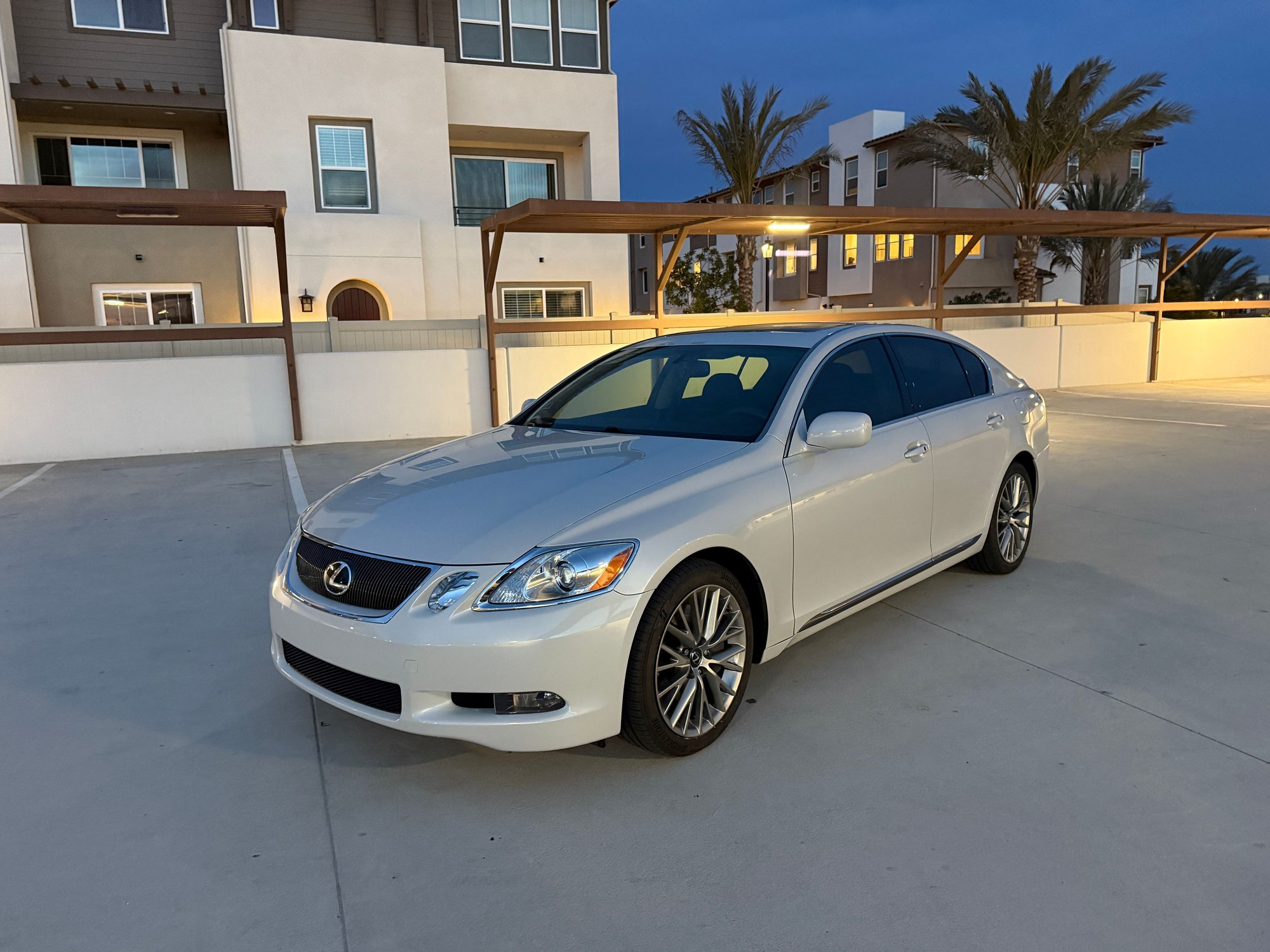

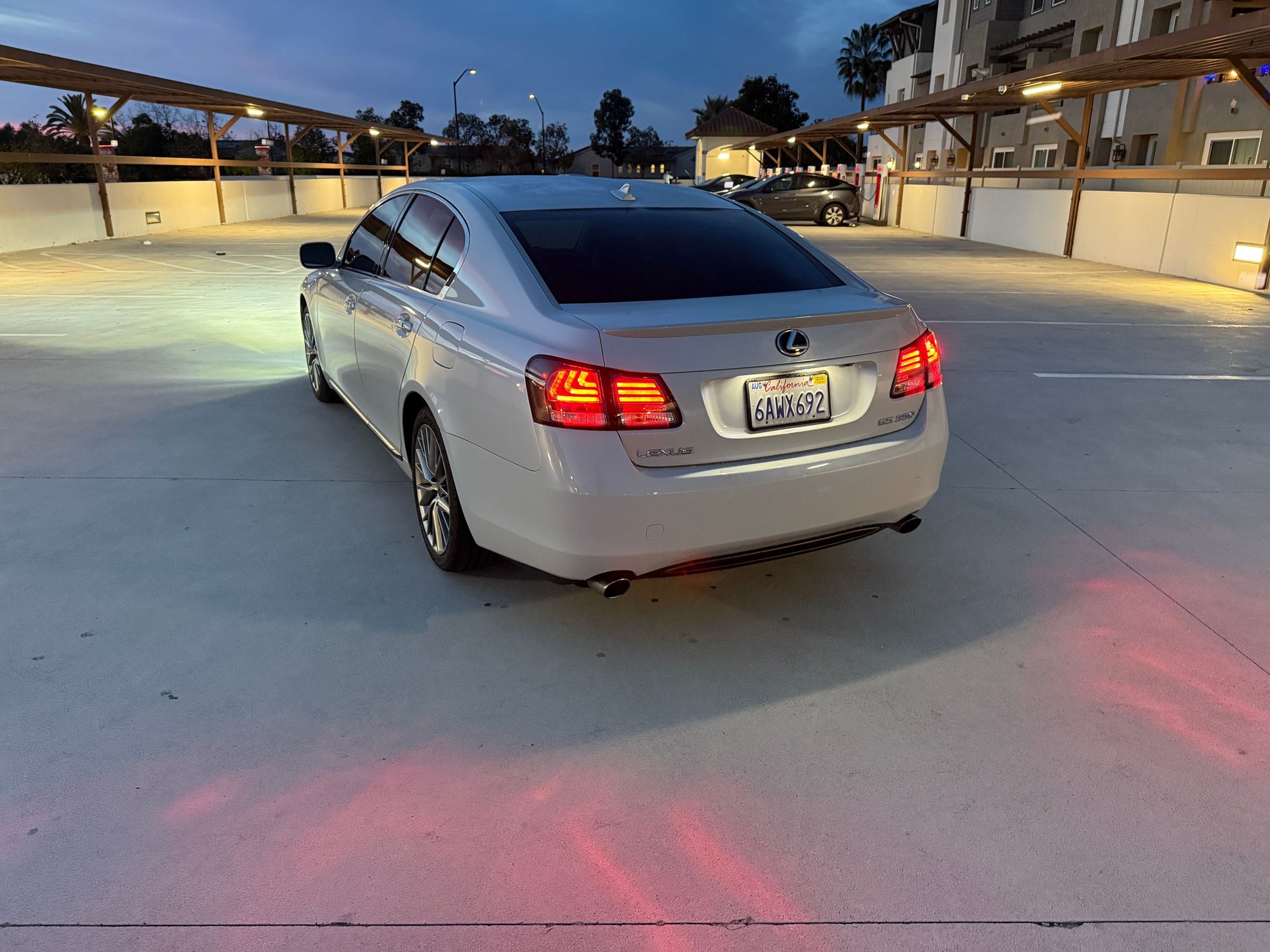

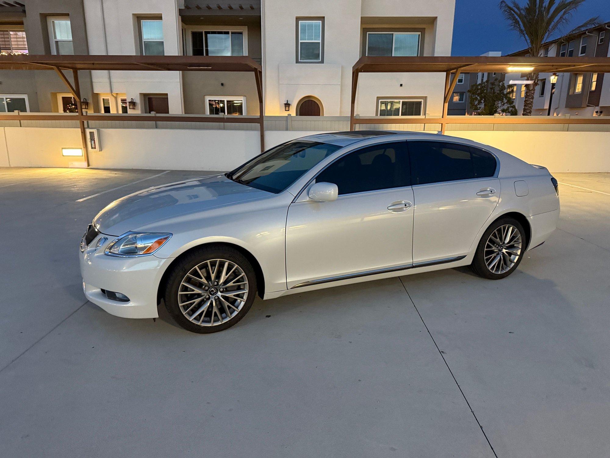

Just got the front and rear bumpers repainted. I decided to do the front plate delete. Exterior mods include new emblems, new grill, 3IS wheels, aftermarket tail lights, and LEDs everywhere. For those considering doing the park assist sensors mod for the 06-07 3GS, DON’T DO IT! Only the refreshed 08+ came pre-wired with the park assist.

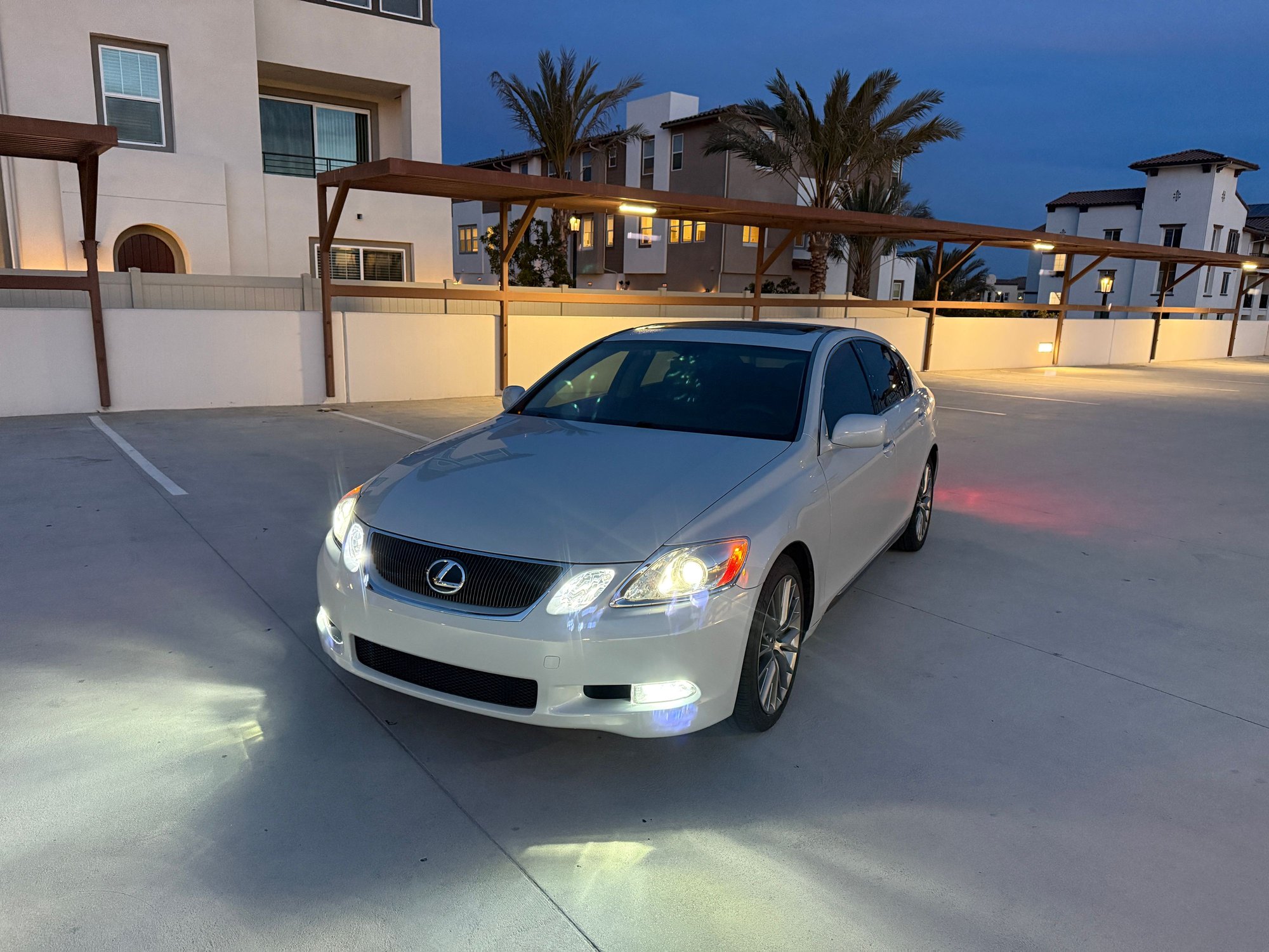

Super clean! Are those replaced headlights or recently polished? I can kinda see a cutoff on the wall in front of you and wondering if thats from yours or another car there. What all kind of bulbs are you running in the headlights, brights and fogs? Looks really good!

Thanks! The headlights have neither been replaced or polished. I bought the car with 65k miles, and it has always been garaged. The headlight lens do have scratches and have developed a slight yellow tint. They’re fine to drive for now, but I’m debating whether I want to replace the lenses or go aftermarket down the road. The cutoff in the pics is from my car.
I’m running LEDs in the brights and fogs. For the low beams, I’m just using a cheap pair of 6000k HIDs from Amazon.
