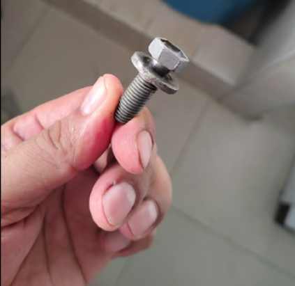

Best Tip Ever:
So the seat are not only getting refinishined, the gears are getting cleaned and regreased. The seat rails, will get refurbished too. But what about the screws that were left behind?
1. Take rusty and lightly corroded screws and bolts and put them in a plastic cup with white vinegar. Leave them overnight.
Then with a brush, i used an old toothbrush, brush them clean.
2. Immediately, drop them in another cup of wash and a teaspoon of baking soda (to nutrilize the acid). Keep them there for about an hour.
Optional: to the head of the screw add a driop of oil and only wipe the top and washer if it has one.
The Result:
As good as new.

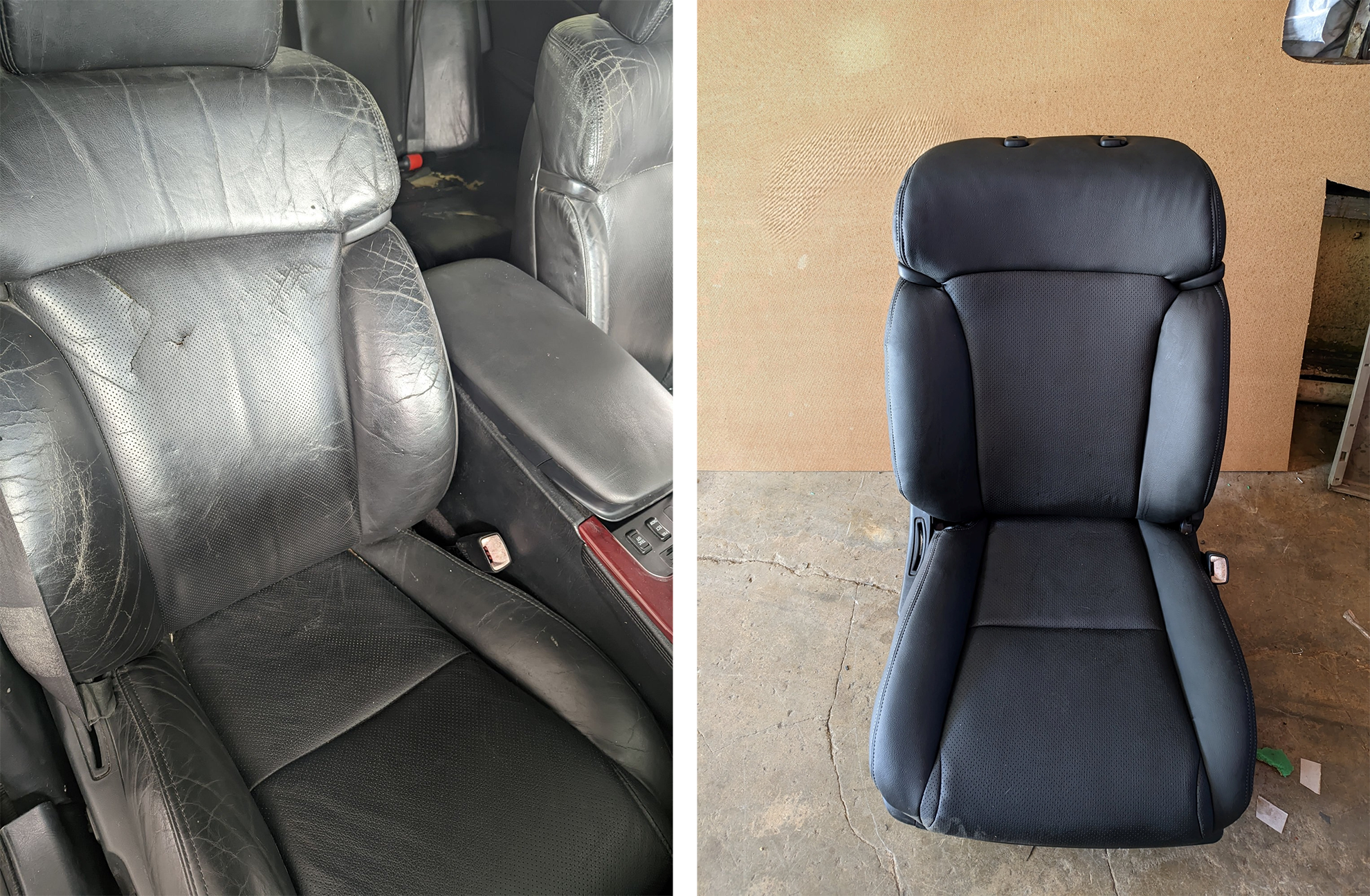

Here is a quick before and after....
