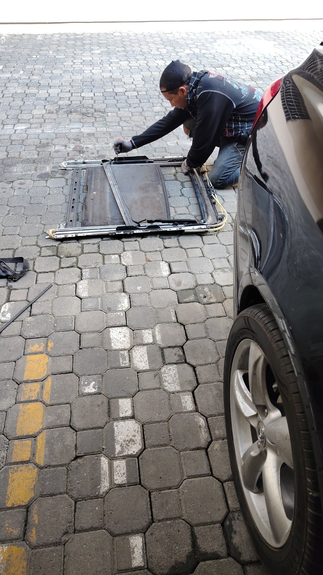

So I had a respitory virus for the last two weeks so I had to take break and focus on getting back to health. So the now we had to tackle a what I thought to be a hardcore job was actually done in 20 minutes. My sunroof didn't work and my mechanic told me that the sunroof belt was broken and I needed to order a replacement, so I ordered a rebuild kit which included the belts. Lesson: DO NOT GET AFTERMARKET BELTS, the don't fit and work. Luckily the sunroof mechanic goes to your house to fix it and he brought original ones, one of the aftermarket ones are too tight and adjusting it snapped. He showed me how my old belt is metal covered in plastic, the aftermarket are plastic and slightly wider. All in all, sunroof, sorted.

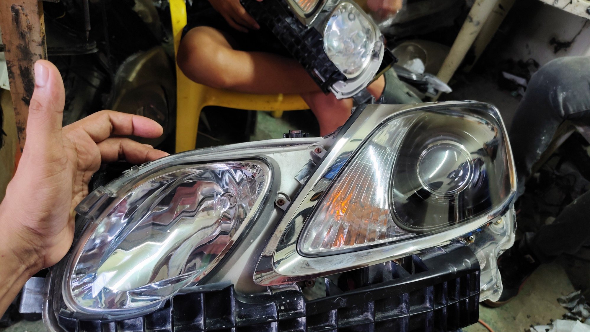

I decided to take my headlights to a restoration specialist. I noticed that one of mine, which was always slightly amber, was turning darker. So since we are respraying the car, might as well get the headlamps refurbished.
Before:
Picking them up
After:
Once the car is done, when it gets ceramic coated, the headlamps will be covered in PPF as well as the corner of the doors.

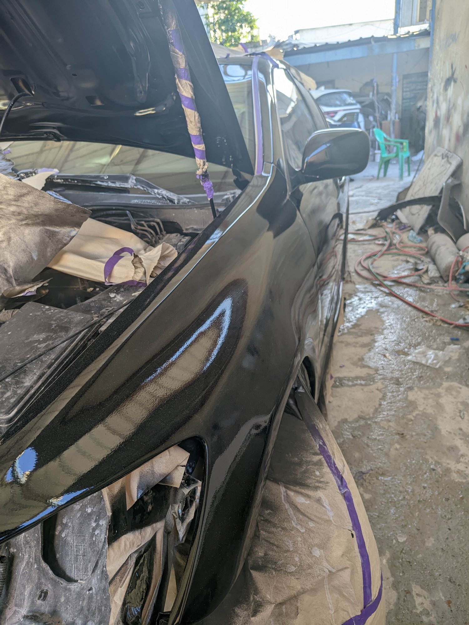

Along with this body work, We adjusted the fenders, and had them resprayed along with the front bumper and the hood, this way we can have better paint matching/blending.
The 'New Hood'is also sprayed and ready for it's accessories.
After all is finished and parts re-installed. The whole car will get a full polishing.

I was a bit naive to think that this job was simple to remove the right fender/wing and do some minor pulling, hammering, finishing, prep and paint, but this is much more complicated than that. It a matter of angles, distortions, alignments and adjustments, so the whole front end needs to come off. The radiator support needs to be set up to take the fenders, which that in itself requires adjusments, then the supports is where the airbox bolts on to, and also the headlights. Then if all is aligned correctly, the radiator and condenser fit with perfectly in place. Sure there might be a mm lost here and there, but I'm happy with how things are coming along.
I was expecting to be back at a body shop, but like my cousin says "If you want it done right, then you have to do it again...right"
