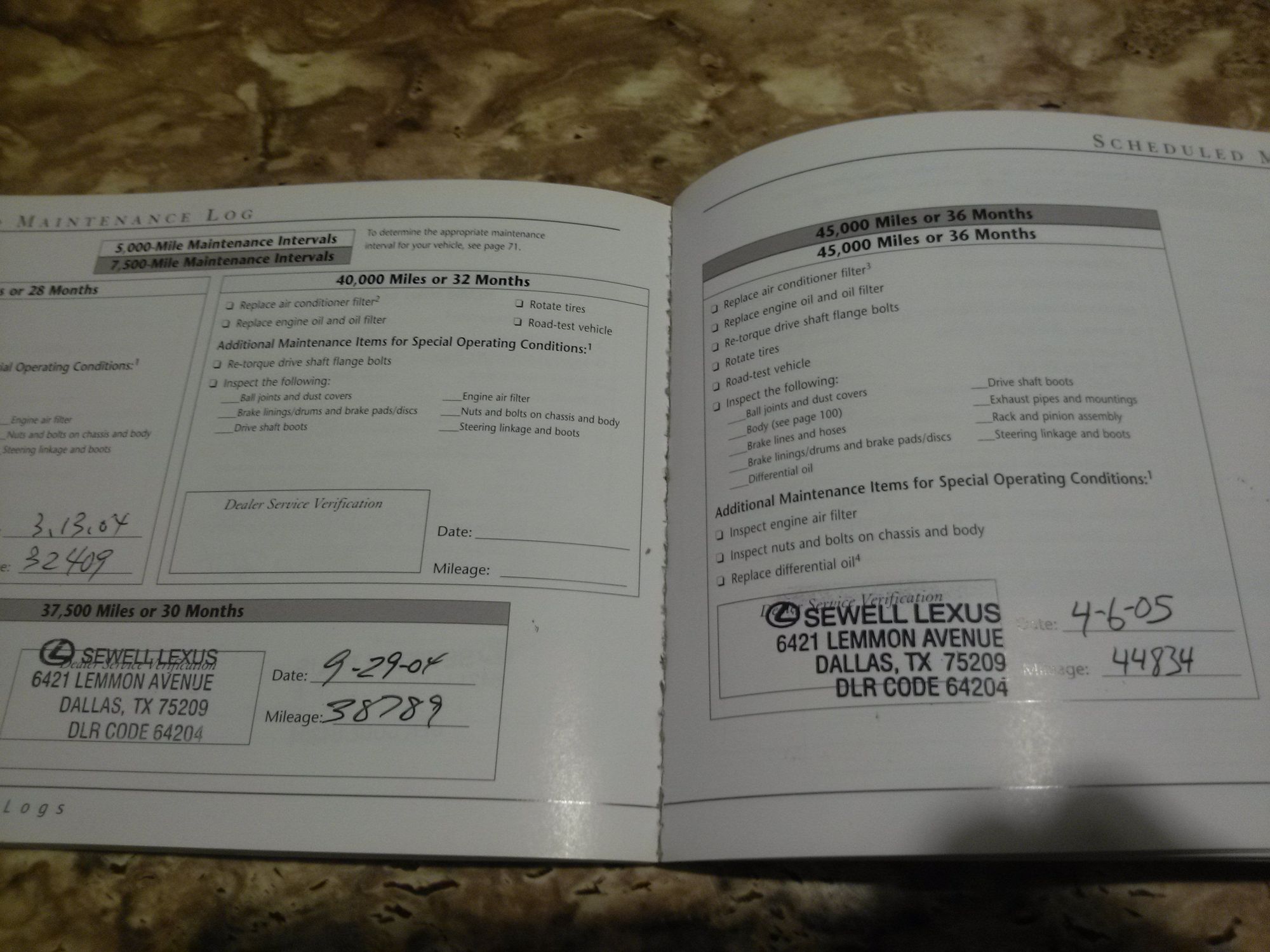

Originally Posted by mademedoit
My Lexus book stops here at 44k. I bought it 5 months ago with 87k. You think its been flushed before? Its says tran fluid at 30k and again at 60k but nothing is checked off.
More worried about the timing belt than dark transmission fluid right now tho.
Just log into the lexusowners site. If you're not registered, it only takes a moment. Add your VIN to your garage. Then you can look at the maintenance history for anything ever done by Lexus.
