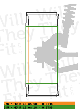

Old 03-29-15, 08:43 AM
  #313
ShawnOk
ShawnOk's Avatar
Join Date: Mar 2013
Location: Oklahoma
Posts: 2,169
Received 89 Likes on 76 Posts
Originally Posted by texsexlex
...thats going to be pretty close,but you might be able to get away with it.If the tires were 35 series, then no problems at all. Is he local, so that you could test fit them ?
Yeah he lives here in Shreveport but I just don't want to get too involved if it won't work. Test fit might be my only option. I believe the center bore on the wheel is 72.6. Our SC's have a 60.1, I think. So I'd need hubcentric rings right?
Old 03-29-15, 09:25 AM
  #314
texsexlex
texsexlex's Avatar
Join Date: Jan 2009
Location: texas
Posts: 1,712
Received 111 Likes on 96 Posts
...yes you would definitely need the hub rings
Old 03-29-15, 09:41 AM
  #315
StillLine
StillLine's Avatar
Join Date: Dec 2012
Location: IL
Posts: 557
Received 13 Likes on 13 Posts
Default Does this help?
Thanks Tex. Owner got back to me and believes the following are the stats:
Tires: 245/40/20
Rims: 20x8.5+42
Do you think they will fit? Will the center bore matter?
Here's some info for you Shawn. BTW, here's the link to the site for wheel/tire comparisons.
Wheel and Tire comparison
