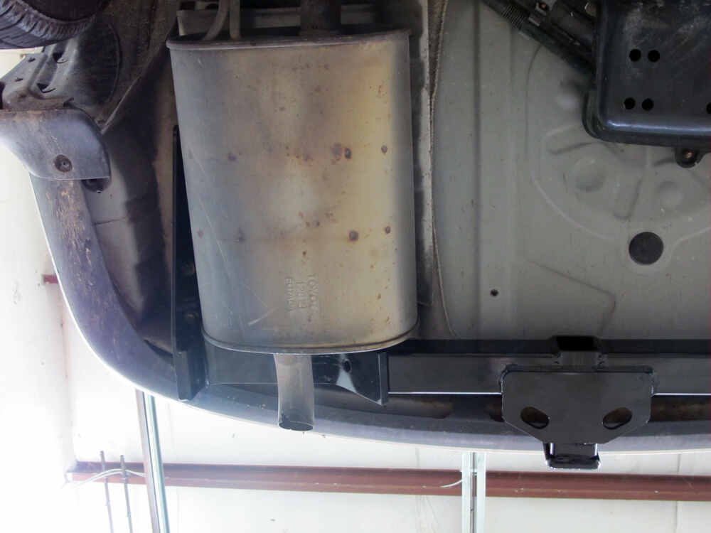

As for the hitch, I found a picture of the installation. Looks like no muffler disassembly required.

I bought my hitch from Lexus Parts and I can vouch that I did not have to touch the exhaust. My electronic module lasted about 7 years, I do like the Lexus kit as it had connectors for the wires and I did not need to splice any wire. As stated above, later models have a different set up.

Tie-down hooks removed, wiring harness installed and pictures taken. Incredibly easy so far. Now to start prepping the hitch for repainting the paint damage due to delivery.
I hardly needed any tools. 3/8" socket wrench, 10mm, 14mm and 17mm sockets, and a breaker bar to get the original 14mm bolts loosened. I put the new bolts in all six points while I'm painting to protect the threads.
