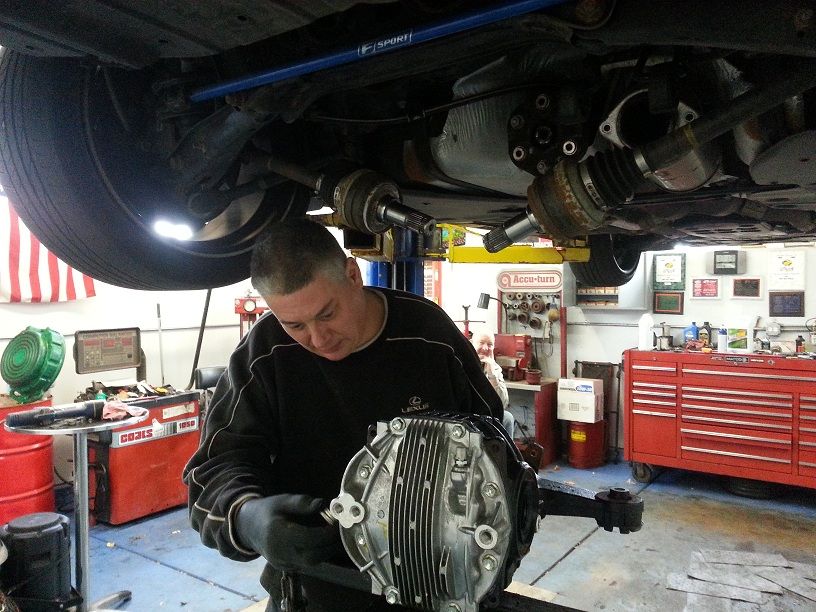

Another shot underneath the car with old rear diff still in.

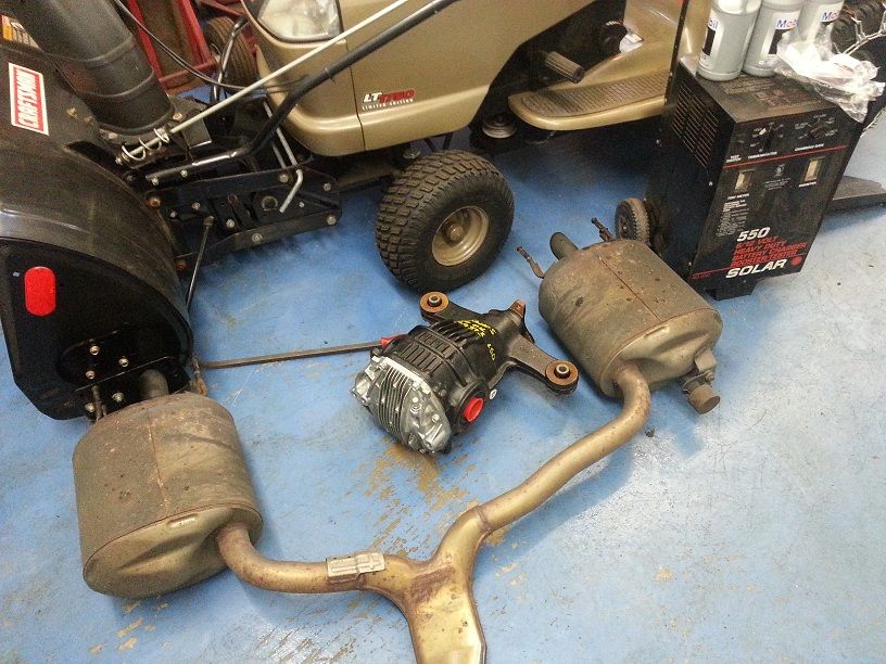

Rear exhaust section on the ground and new 2010 Diff.

08 Diff out and 10 Diff sitting on trans jack, putting lube on seals.
