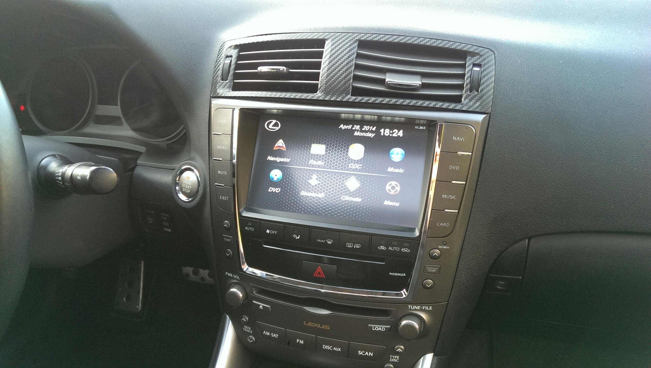

Completed product:

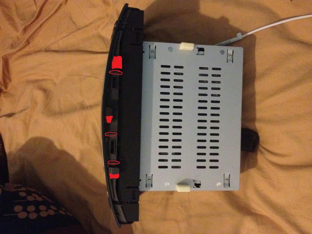

You will need to cut out the red marks in the picture below. (This pic was created by someone else on the forum)

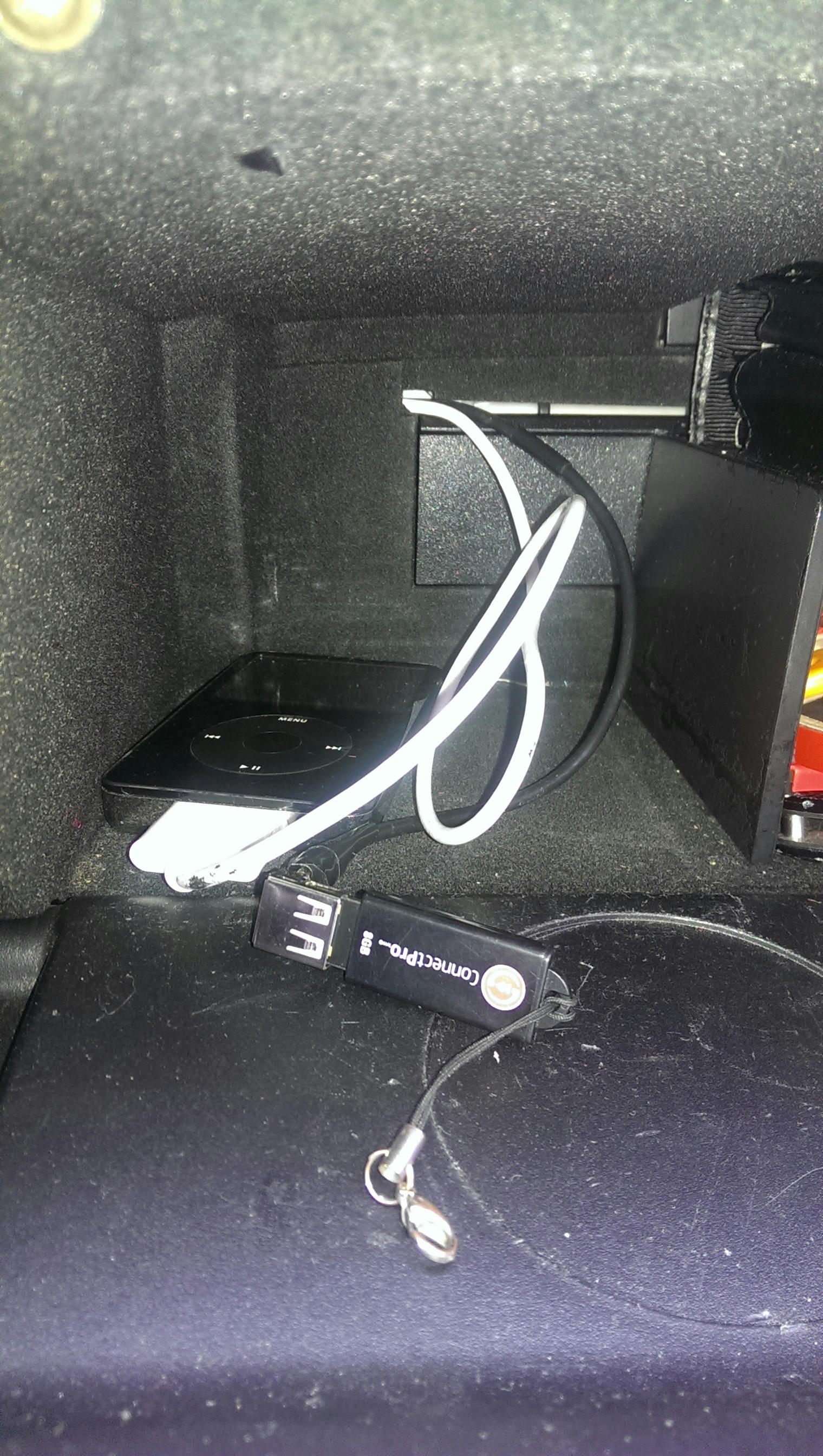

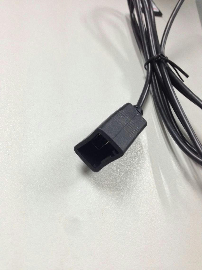

The USB plug (shown below) is a male plug that is meant to plug into the back of the factory USB plug. Since the 2006 models do not have this, the best option is to cut it off and solder on a female connector. (Please note that the pins aren't the same layout as a standard USB Plug, which means a female to female USB gender bender will not work. But the wires inside are the standard colour code.
Before:
After (Also shows where I ran the USB and iPOD cable):
I would recommend doing the soldering before the install. It is a bit scary soldering inside the car.

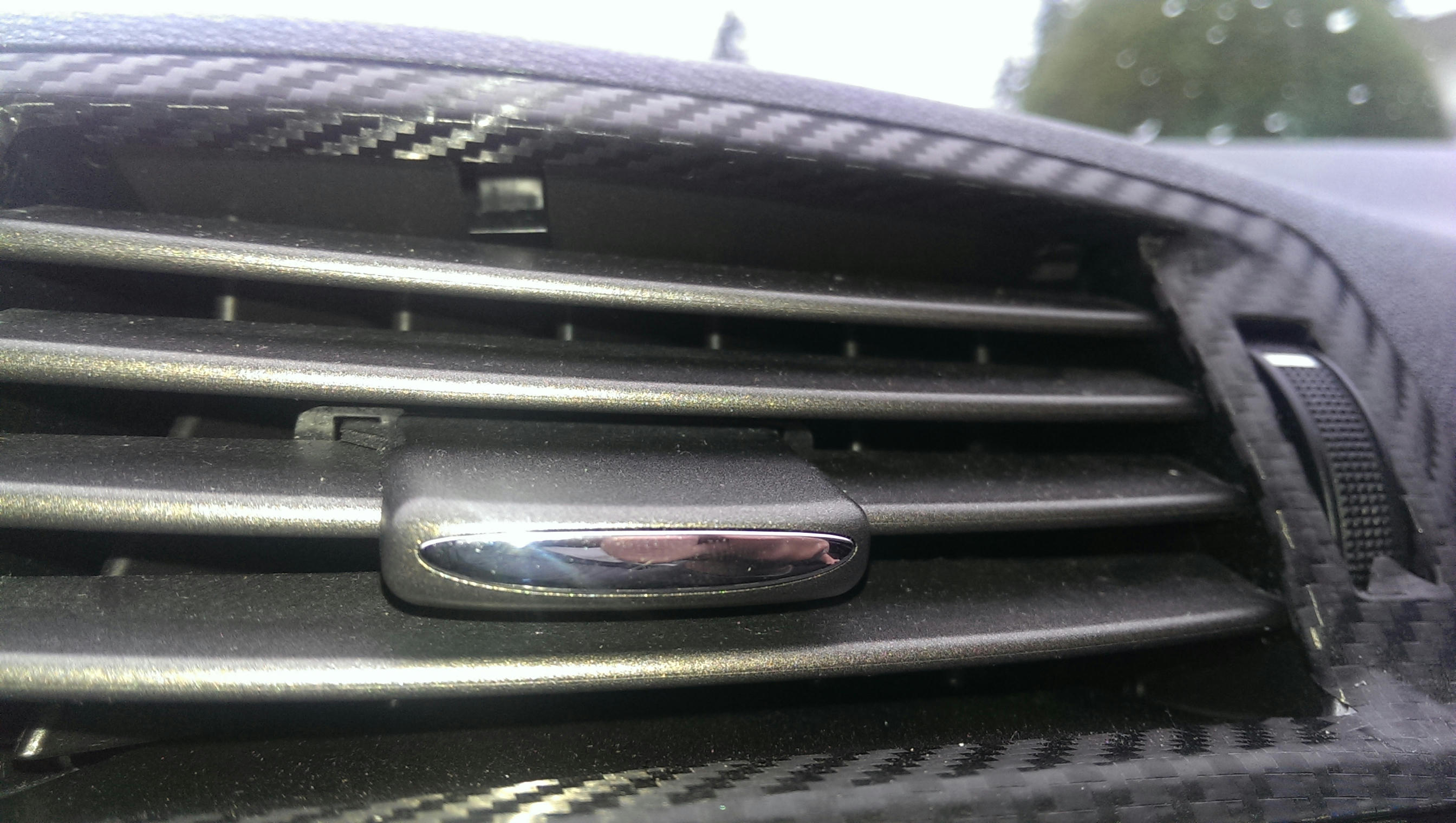

The vent removal is probably the hardest part if you do not know where the tabs are located. Each one must be popped down with a flat head screw driver before the vent will come out nicely.

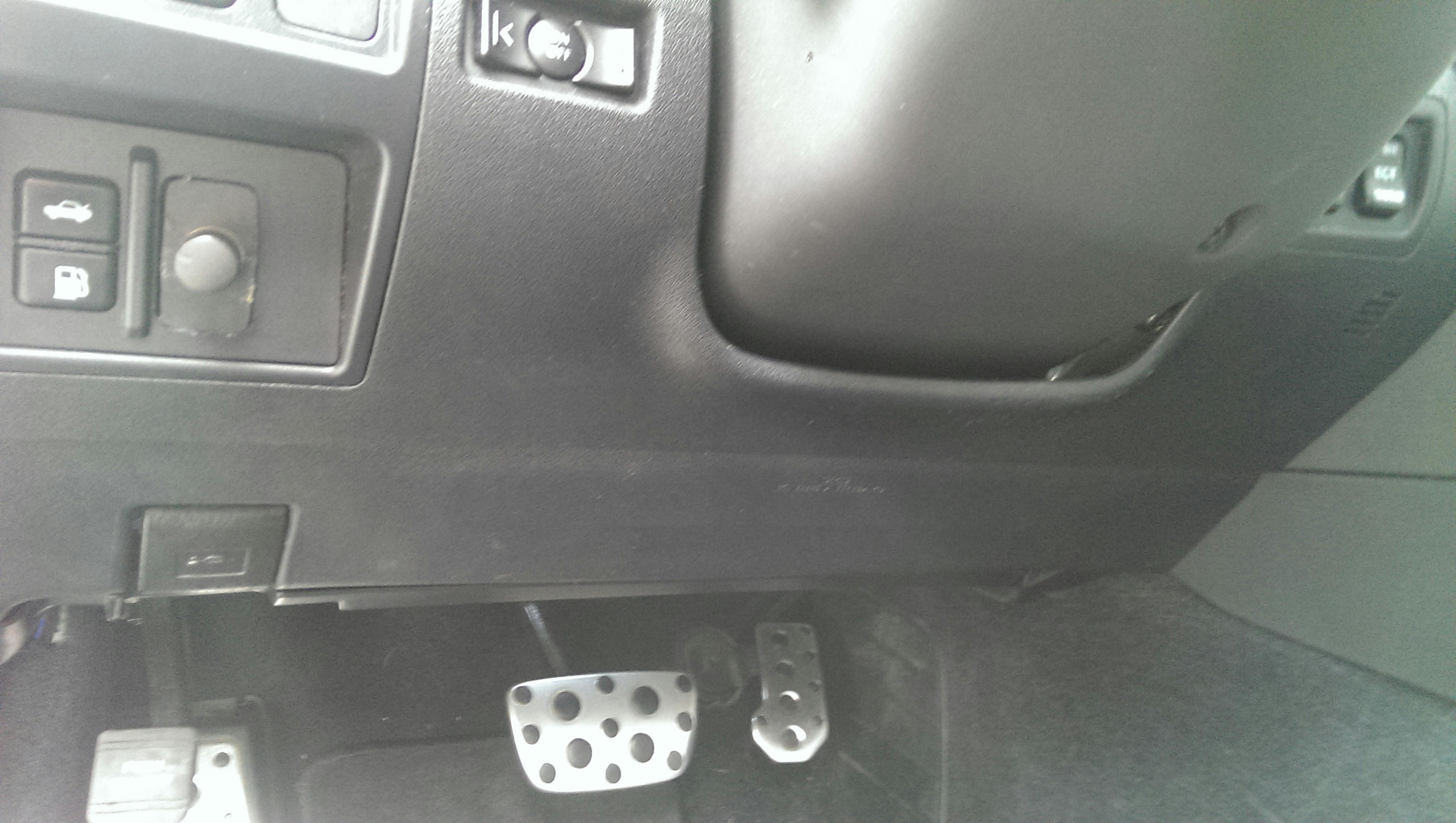

By removing the panel below the steering wheel and on the left of the dash, you can easily route the cable.

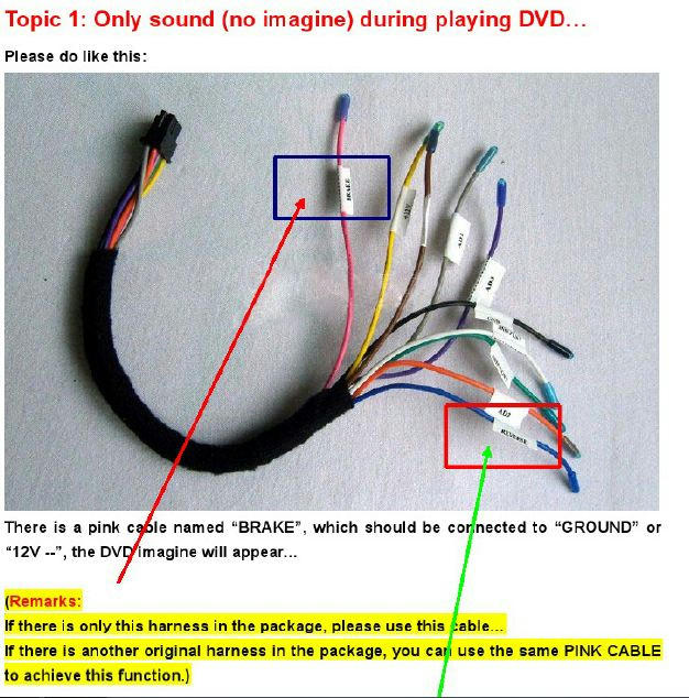

If you want to play movies while driving (or even if you don't) I recommend grounding the pink brake wire. This makes the unit think you have the parking brake on.

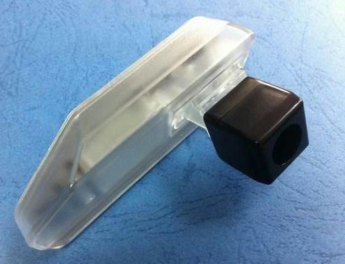

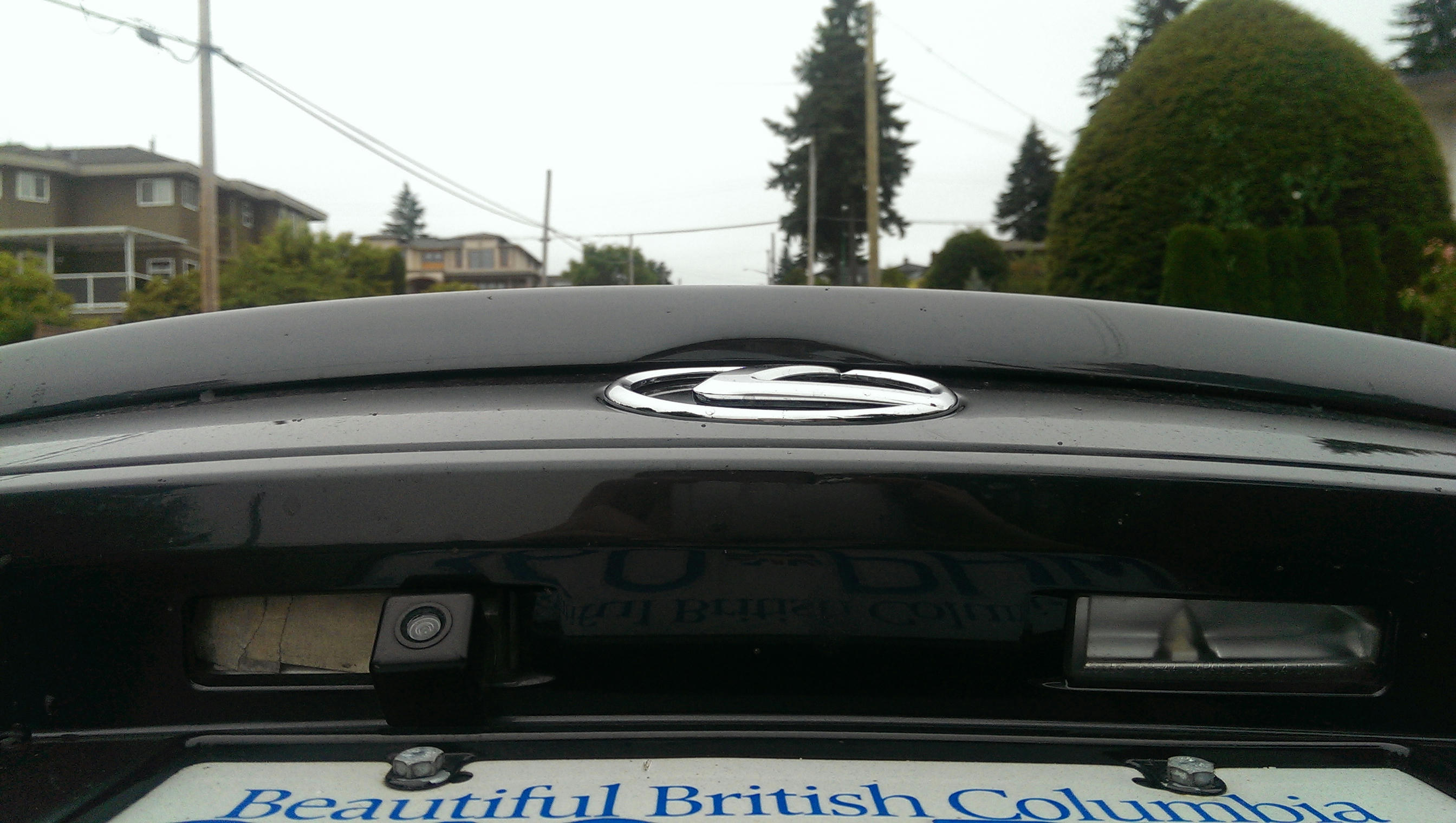

Now we come to the backup camera, I went with the OEM style. This is not like the OEM camera that would come with the car, but one that uses the license plate LED housing, meaning no drilling holes.

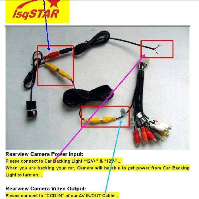

Here is a quick diagram of how to wire it up:
For the camera power and reverse signal, I tapped into the reverse bulb power, since it is right in the trunk lid by the camera. I am pretty sure the video cable that comes with the camera also has an additional wire, which is to be used as the reverse signal that goes back to the navigation unit.
Now to physically install the camera is a bit of a pain. Once you run the wires all the way to the trunk, to get out the LED housing, you have to remove the outside painted panel on the trunk. Start by removing the inside carpeted portion, remove the nuts holding the back outer piece in place then the outer piece should pop off. Be VERY careful that you don't bend or crack this piece!
Next you will need to remove the stock LED housing and install the new camera housing. As is, it will not fit. You must separate the black camera cube from the housing and feed them through separately then reconnect once inside.
I also noticed that the new LED is sort of blue, where as the older one is more of a white/yellow. To fix this, put on a couple layers of masking tape (seriously, works perfect).

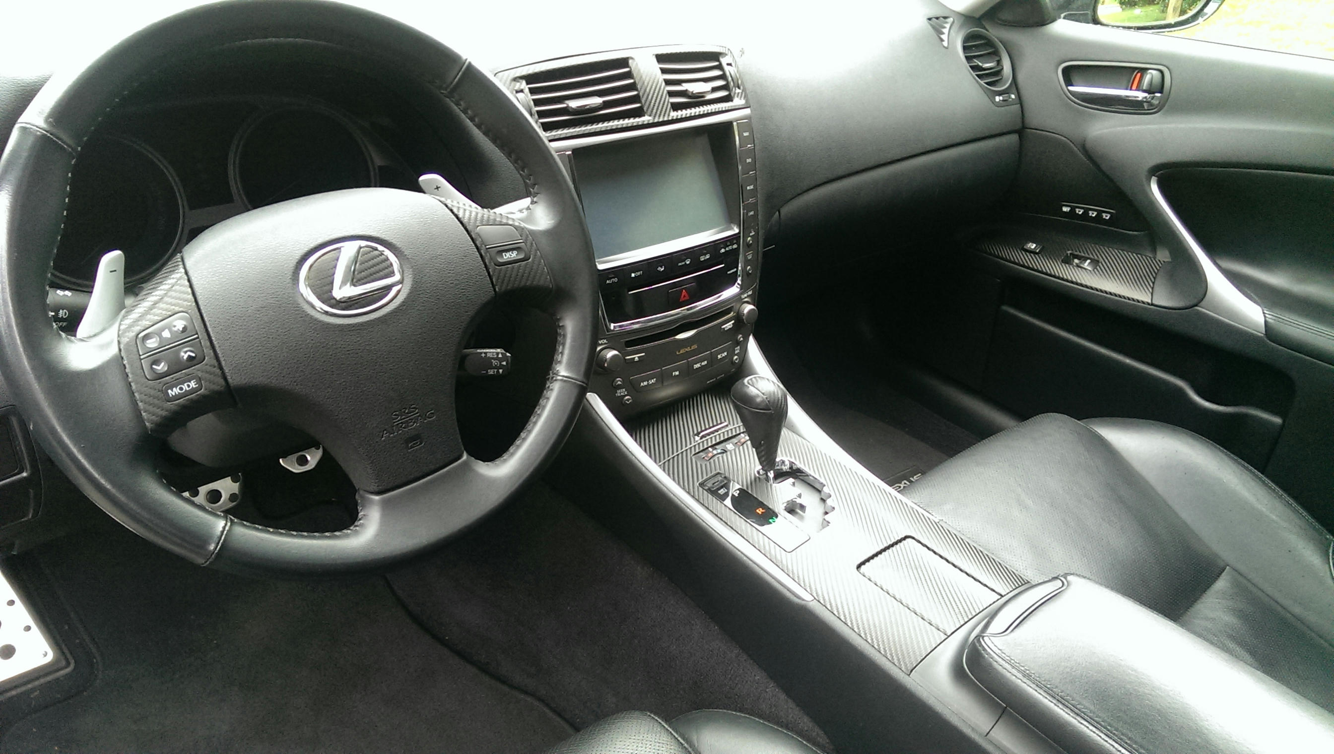

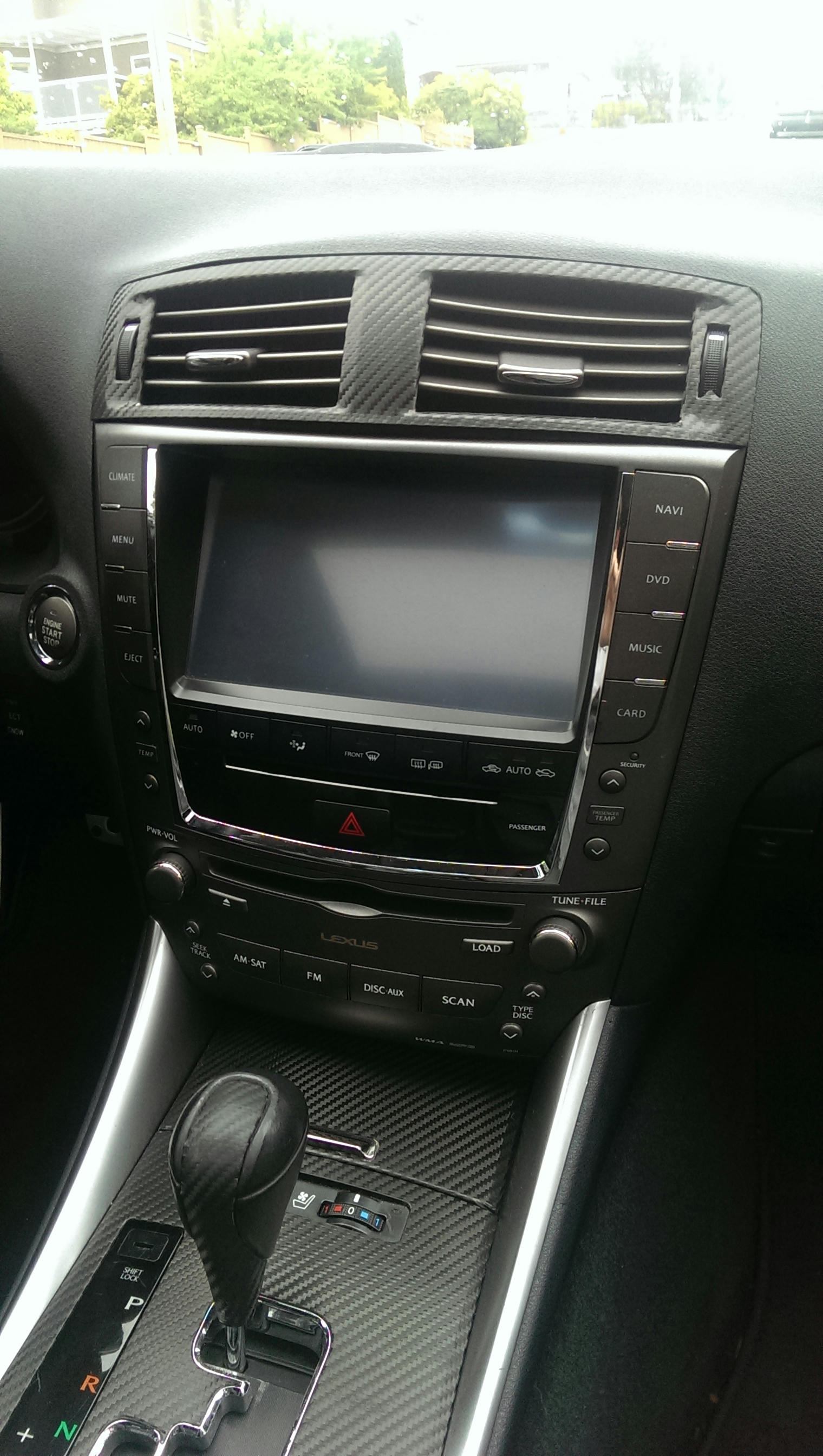

And finally, here are some pics of my completed install. You will notice that I have used 3M 1080 carbon fiber wrap on the AC vents, I also got some stick on foam weather proofing and cut it to fit nicely in the gap. This greatly improved the looks of the gap without having to spend $200 on a new 09+ vent.
