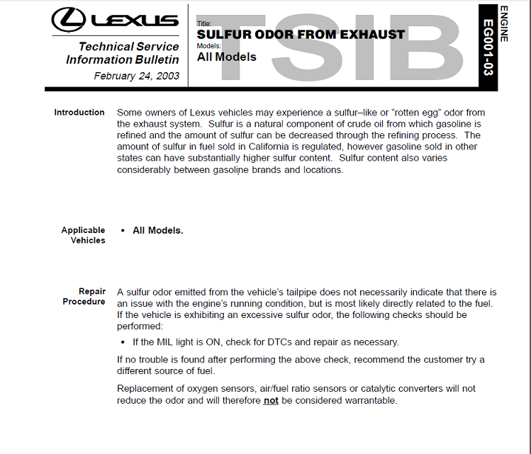

There is a TSIB that addresses this concern and according to it, if no check engine light comes on, then it may be the characteristic of it. Maybe trying a different gas station?
