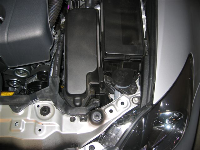

Simple question, just curious as to what the box in the center is/what it controls etc? (not the fuse box on the right)
Any info would be great, Thanks!

is that your fuse box?
and wow that is a very clean engine bay

The Fuse box is on the right. I'm not sure what the other box is... (First post updated to clarify)

one of the control units; iirc, the TCU (transmission control unit).
Thanks for the reply, can anyone confirm?

thats actually the ECM/ECU. i know this because mine got broken in my car acident(front end collission) and i had to wait 2 months for the backorder piece of **** part to get over here from japan...
its expensive, don't touch it :P

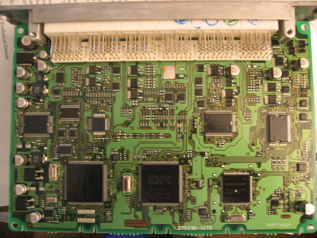

edit: is it official called a engine control "module" or engine control "unit"? haha idk. i have my broken one laying around somewhere. what actually broke was one of the mounting tabs, the actual circuit board and stuff is still in tact. i took it apart for fun. if you take it out of the plastic cover part, there is a metal case inside(which my tab broke off) and then open up the metal case to reveal a circuit board inside.

I've opened up that center box, it does look like another fuse box, but it's actually a PCB.... so leaning towards ECU/TCU

This is what I suspected, but am wondering if it has ANYTHING to do with the P/S?...

Not directly. It is undoubtedly the ECM (Toyota speak - all the other manufacturers call it an ECU). It looks like this inside:
It would be a bad idea to have electrical interference anywhere near this computer.

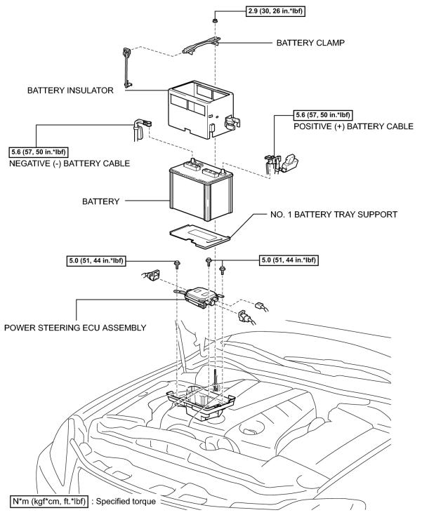

The power steering ECU is underneath the battery tray.

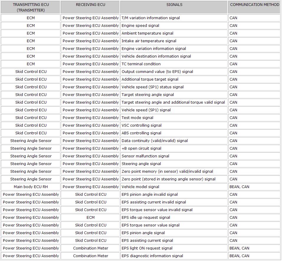

This might also be helpful to understand what's going on:

I can tell you that both of my Ballasts are very close to both the main ECU and the P/S ECU as recommended in muzzman1's HID Install thread.
That tells me that if my P/S problems were caused by the ballasts, it could have been either one. So now I know to move both ballasts further away from both ECU's...
