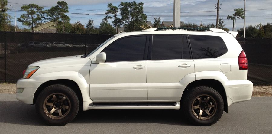

Here's how it sits now:
Looks to sit very similar to mine, rear slightly taller than the front. I'll try and snap a current pic of mine and post it up as well. The 265/70/17 tires I'm running fill out the wheel wells very nicely, are you also running slightly oversize tires? Your truck looks great, love the white!

That would be nice to get some ideas of how other stock GXs sit.
When I installed the rear Bilsteins I took some measurements and the rear of my GX is almost exactly where it should be per Lexus specs so I don't know why I was bottoming out? My sensors are fine, my airbags hold air, my rear stock shocks were bad and I was hoping the Bilsteins alone would take care of the bottom out but they didn't.
Anyway here's the measurements;
MY MEASUREMENTS
  • C (14.875") - D (11.3125") = 3.56" | Per Lexus it should be 3.04"
  • ** I'm running 1" larger diameter tires so if you deduct 0.50" from 3.56" above I'm at 3.06" which is 0.51mm higher than the stock spec
Yes, I'm running tires that are 1" larger in diameter than our stock tires.

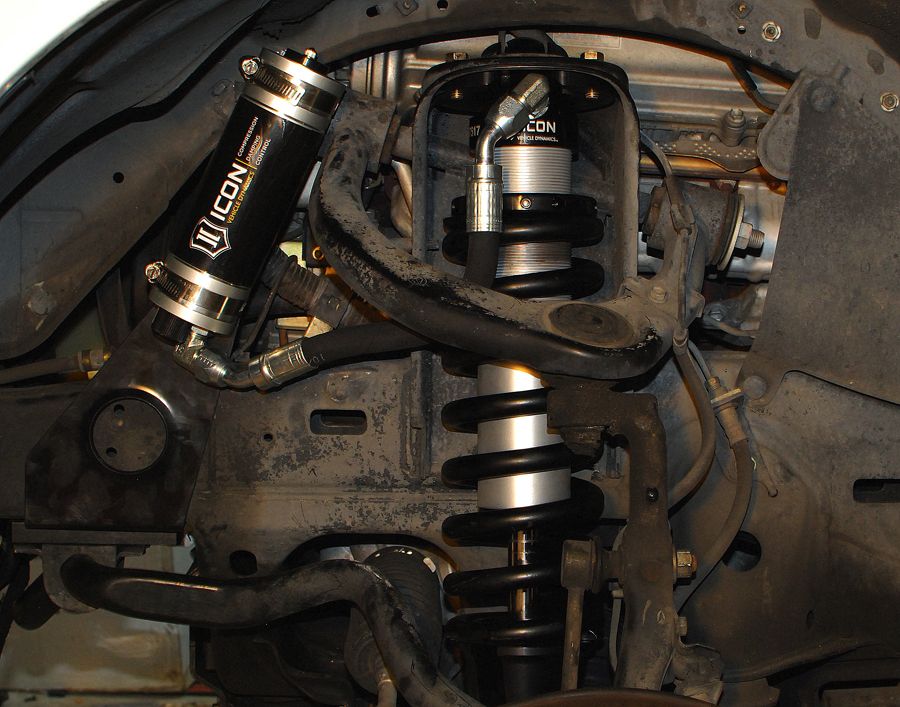

I did this....

That is 7 different kinds of sexy!

thanks.
I'm loving it. It's like a whole new GX!

How did the ride change? Firmer? Harsher? Bodyroll? I'm guessing you can tune these to do whatever you'd like, but still thought I'd ask.

I'll just copy and paste from my other thread but no, no body roll or nose dive even at the softest setting.
"The ride, all I can say is WOW, the Icons soak up bumps like they're not even there. I rode around town and on the beltway and they performed great at lower and at higher speeds. Being 2 1/2" higher it feels weird not seeing the hood slope down from the drivers seat anymore. I pulled over numerous times to change the CDC setting and here's my opinion;
S is the softest setting. It's VERY plush and literally feels like you're riding on air. I've never rode on new GX shocks but I can bet they're not as plush as this! You can't feel any bumps they just soak them right up yet you don't get that squishy / squirmy / floaty feeling what so ever. I then tried H and it was way too firm and really unpleasant. I didn't even drive 1/2 mile before I switched it to a lower setting. I'd personally never use the H setting. I then tried 6 and while it was much better than H it was still a little too firm. I took it down to 4, which if you order standard Icon coilovers without the CDC valve that's what they feel like. It was nice and firm, not too firm though and was very drivable but I want the Lexus plush ride, so I tried 2 and perfection!! It soaks up bumps just like S but it's not as soft but still VERY plush, it's like the road is made of marshmallows. The compression is nice and soft and the rebound is quick so there's no floating feeling at all."

Wish I could buy another GX and do this. So nice.
