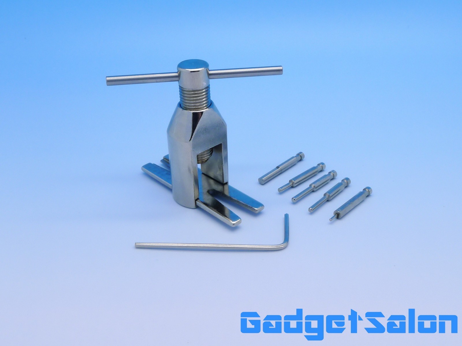

Originally Posted by TI II
Which length is needed to do the front
This is the gear puller?
So after removing the plastic piece off the old motor shaft with the gear puller how did everyone put that piece on the new motor? I don't want to hammer it in, what methods did you guys use?
