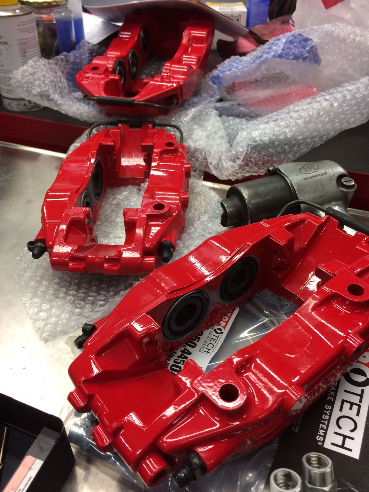

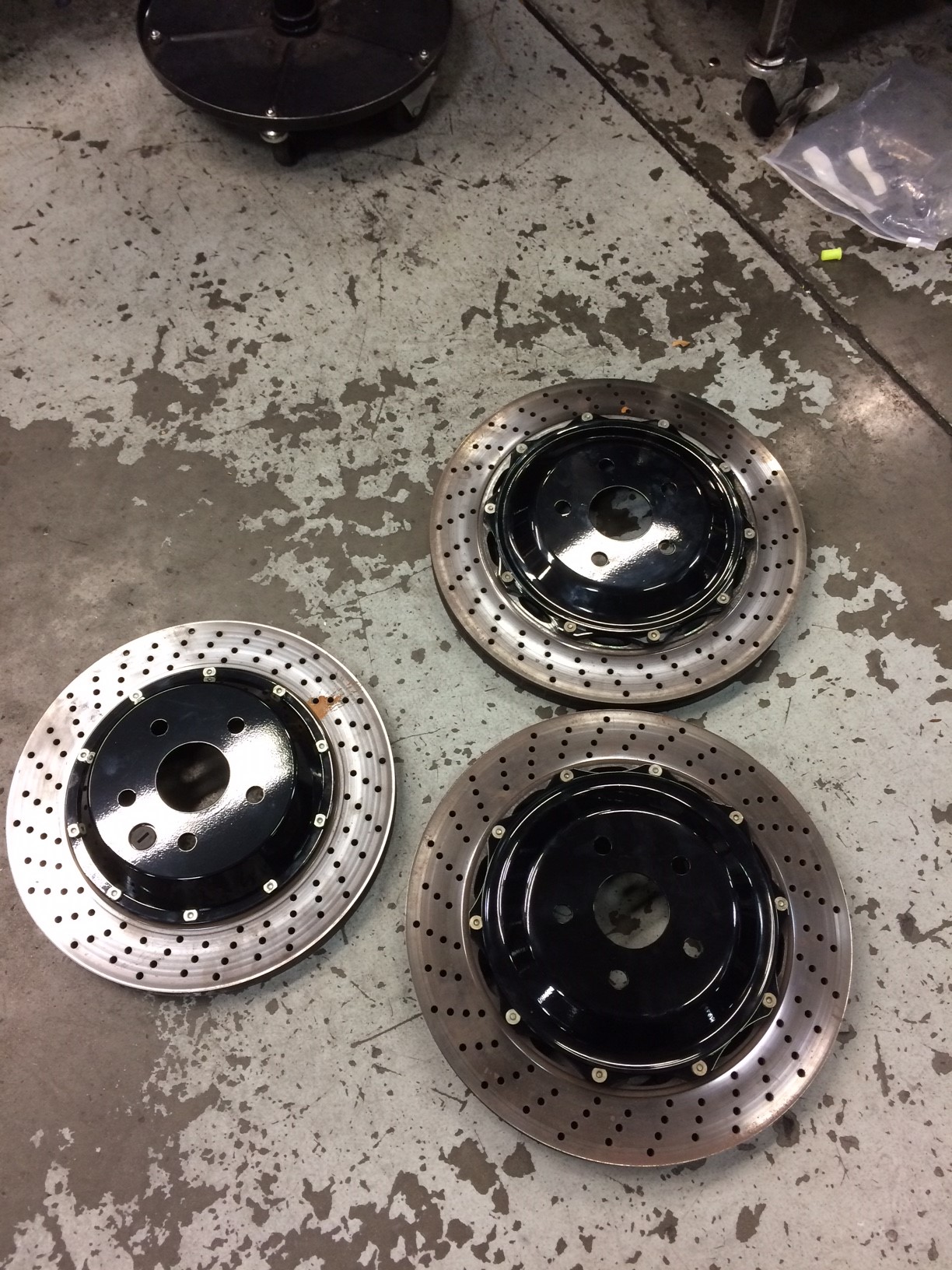

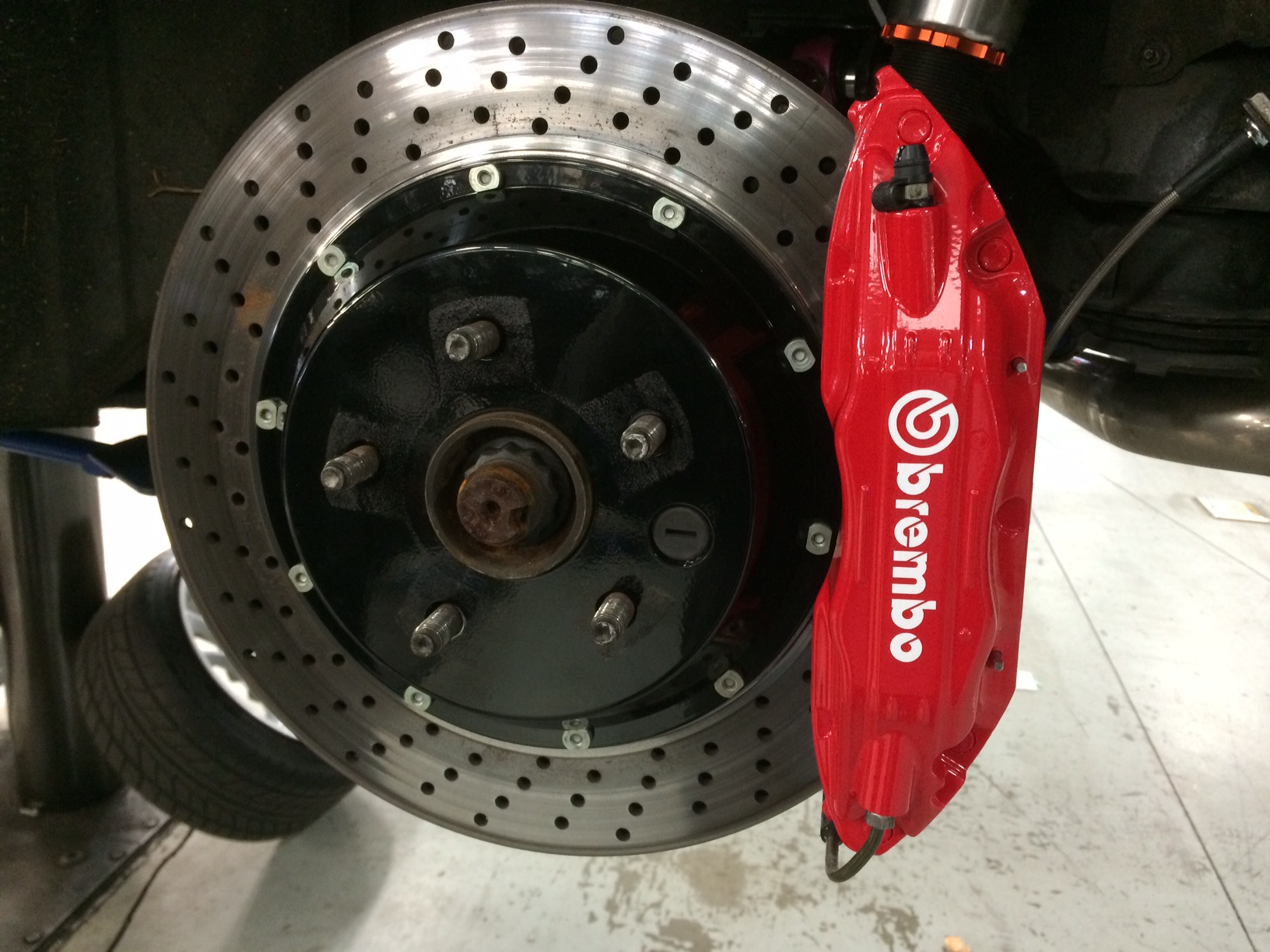

Haven't posted up here in a while...been busy assembling parts for my current build and getting things organized.
Well, finally things have been moving along. I purchased the Brembo GT BBK from Mike, and had the calipers powdered a Ferrari Corsa red and the rotor hats jet black. When installing, we had to completely remove all the dust shields due to the crazy size of the rotors. In the process we also installed stainless brake lines. I am very happy with the results, with the pedal feel and the look.
I know I don't have the best pictures, as the next phase is already underway...will post some teaser pics in a few.

Loving your BBKs!
Not to pop your bubble but there are some important cracks on the rotors that need to be checked

Originally Posted by 3sm1l
Loving your BBKs!
Thanks!!! I don't think those are cracks, must be something on the rotors or the back phone pics. There is nothing concerning, but thanks.
